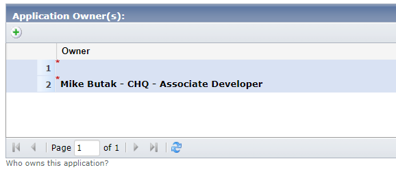

    I've built a form with a table component having allow edits = false, allow inserts = true.
    There are two ways to add a row:
    1. One can manually add rows using the "+" button.
    2. I have a script that enables the user to add self or manager as rows using ca_fdAddTableRow function.
    Either way works just fine by itself.  However, if one manually enters a row, and then subsequently invokes the script that adds self or manager, it enters a blank line.
    Not sure if it matters but the row element is a select box.
    There are no errors in the console when the function is invoked (undefined variables, etc.)
    Seems like this could be a bug in the ca_fdAddTableRow function?
    See screenshot:
    Thank you!

    Hi Mike,
    You need to supply the id of the select column in addTableRow. Can you share an example of the call?
  • 3.  Re: AddTableRow bug - enters a blank line.
    Posted Nov 09, 2018 12:52 PM
    Never mind I read the post again and understand.. Do you have eager set to true for the select field?
  • 4.  Re: AddTableRow bug - enters a blank line.
    Posted Nov 09, 2018 01:02 PM
    Hi Grant,
    I did not have eager set to true, but fixing that did not change the behavior of the form.  Thanks for the tip though!
    Michael
