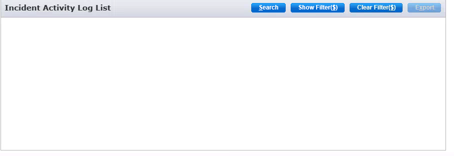

    I am getting blank screen at the logs section.
    Please share your inputs on the same.

    Thanks for the solution. I resolved by replacing capital F of function to small f.
    Thanks Turker.
