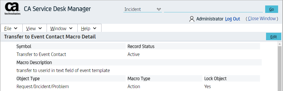

  • 3.  Re: Transfer ticket for SLA Violation
    Posted Oct 16, 2017 02:25 AM
    thankS Kyle for your reply, what i want to achieve here is to change assignee / group to a new name and site defined condition macro maybe help; but appreciate if u have a screenshot of a working transfer to event contact/group macro because iam confused a littile bit about how to use this kind of macro. Because i dont know where shall i put the userid or groupid of the event template.

    Hi Mohamed,
    We have an out of the box Action Macro to change the assignee but, unfortunately the value would be static. The Macro is called:
    Transfer to Event Contact
    and you would define the contact in the text field of the event firing this macro.
  • 8.  Re: Transfer ticket for SLA Violation
    Posted Oct 17, 2017 06:24 PM
    Thanks anthony for ur reply, is there’s any special format to write the contact/group name in the text field. i.e ‘userid’ appreciate if u have sample or screenshot
  • 9.  Re: Transfer ticket for SLA Violation
    Posted Oct 18, 2017 01:52 PM
    A contact has a userid field. That is what it is looking for. So like the ServiceDesk user has a userid of ServiceDesk.
