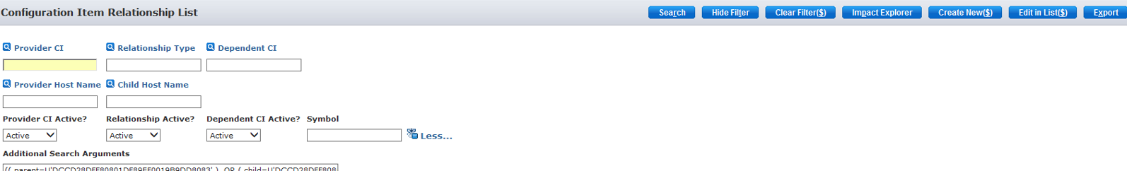

This produced the following page:
But.. when you click on to search for either "Provider Host Name" or "Child Host Name", it goes straight to "Incident List". I'm scratching my head because I thought I had the attribute name correct (see above). Can anyone see the problem with the code?
