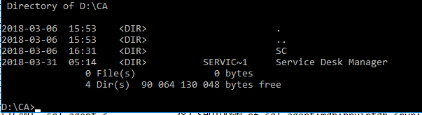

    I just noticed that your installation was done under the E: \.
    Is 8dot3name enabled on the E: \.
    One way to see if the "Service Desk Manager" directory has activated its short name, you run the dir / x command in an MS-DOS window. (see screenshot)
    If you cant find (SERVIC~1) the short name is not activated.
    Service Desk needs short name when it tries to execute some script. If 8dot3name is not activated, you will have problems without stopping.
     - What I suggest you do is uninstall Service Desk in full,
     - You also erase all CA directories.
     - You open an MS-DOS prompt as administrator.
     - You execute the command: fsutil 8dot3name set E: 0
    After you re-install Service Desk from the beginning and inform us during the installation.
    I had exactly the same problem, Microsoft does not auto-enable the generation of short names on the disk.
