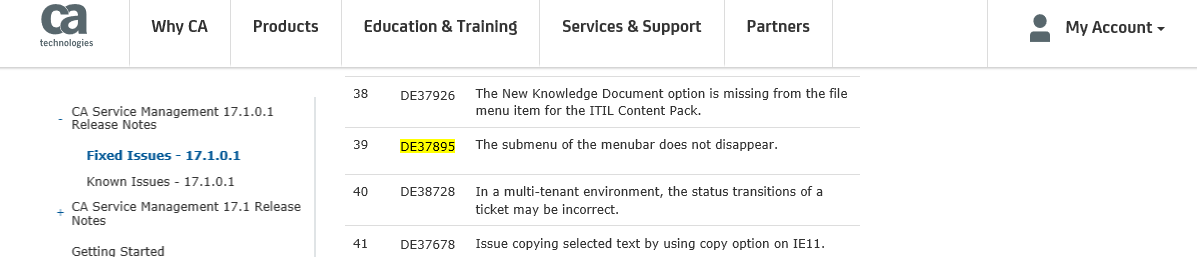

    Marek, this is a known issue DE37895. Please open a Support case and have the Support engineer attach this DE to the case. Currently CA CV Team is working for a fix for this DE DE37895. Thanks _Chi

    The solution has been included in the 17.1 rollup patch ( SO03787 ).
    Fixed Issues - 17.1.0.1 - CA Service Management - 17.1 - CA Technologies Documentation
