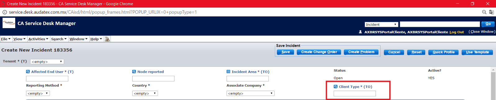

    I'm working with CA SDM, I've created a custom field as follows:
    1. create custom table "z"
      Attributes: sym, del
    2, create attribute in the table CR with the name zClientT, it refers "SREL" to the table created in point 1
    3. modify the web form detail_in, but when I publish the field, it is shown as follows.

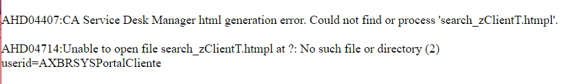

    4. When I click, it shows me the following error.
    5. The ClientT field is the same as the fields: Country, Reporting method and Associate company.
    attachment: Codigo line
    <PDM_MACRO name=dtlDropdown hdr="Client Type" attr=zClientT lookup=no>      --> Field that is inconsistent

    Hi Marco,
    You need to create a list and detail form for the new table. You can use the file menu in web screen painter to walk you through creating the forms.
  • 3.  Re: Field that is inconsistent
    Posted Jan 08, 2017 05:09 PM
    Create the file list, and the error was resolved thanks.
