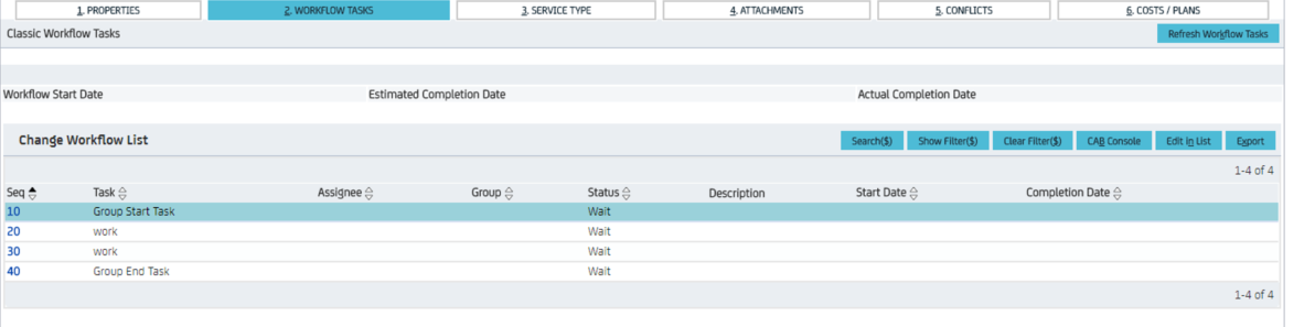

    Hi,
    I try create parallel workflow task via spell.
    The problem is that when I add tasks via spell to the change order all newly added tasks are with status "WAIT", instead of the first task wil get status "PENDING" and all the other status WAIT:
    This is my code:

    What did I do wrong in the code?

    I used your intial code , and added  the setting of the group_task attribute to 1 for the first three tasks. Then I created a new change order with a category through the UI. Worked like a charm.
  • 13.  Re: create workflow via SPL Code
    Posted Feb 14, 2018 11:20 AM
    Hi Vladimir.
    Sorry, I pointed you in the wrong direction.
    I found the problem.
    You need to specify a change category. If the category is empty the start of the workflow ( chg POSTCI postci_start_process ) will just exit !
    Additionally you need to set the group_task flag to 1 for the Group Start task and all tasks within the parallel group. Otherwise only the first task inside your Group will be started.
    It will even work with your original POST_VALIDATE trigger.
    Please give me an idea, why are you trying to add wf tasks by your own code ?
    Hope that helps finally
    Regards
    ...........Michael
