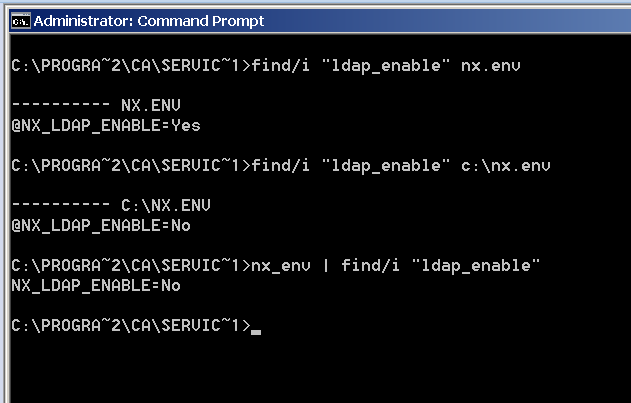

  • 17.  Re: LDAP_SYNC Error: 'LDAP is not enabled'
    Posted Sep 14, 2017 01:21 PM
    Hello Jordan,
    From the discussion and test done, we may be in this situation.
    The nx.env in servicedesk root directory state ldap_enable=yes
    @NX_LDAP_ENABLE=Yes
    But servicedesk seems to not use it
    We have this side effect to take account
    We are expecting servicedesk use NX_ROOT\nx.env , but when c:\nx.env exist , it will be used
    execute nx_env at the command prompt to see the current value
    If you have nx.env on the root of the drive, stop sdm, move the c:\nx.env to another folder , restart sdm and test again
    Best regards,
    Chris
  • 18.  Re: LDAP_SYNC Error: 'LDAP is not enabled'
    Posted Sep 14, 2017 04:35 PM
    Hi Chris,
    Here are my results:
    The issue you described does not appear to be a problem within this environment.
    Many thanks,
    Jordan
