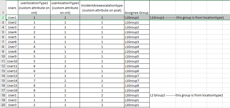

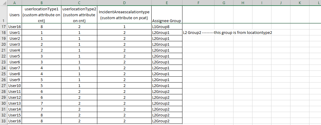

    Hi Jon,
    Thanks for sharing your thoughts.
    Currently service desk is in use by customer and all out of the box fields (including location) are in use for other workflows.
    But now customer is looking for assignment based on location, but location field is in use for different purpose in score board, data partitions and other spel code driven workflows.
    Please suggest if you have any custom solution available to assignee group on tickets as per combination of custom attribute value of customer location and incident areas.
    Attached scenario in file.
    here selection of group first depend upon incidentAreaescalationtype value , if value is 1 , then group selection is based upon userlocationType1 and if value is 2 then group selection is based upon userlocationType2.
    Group are also created as per grouplocationtype1 and grouplocationtype2
    userlocationType1   SREL to locationType1 table
    userlocationType2  SREL to locationType2
    grouplocationtype1 SREL to locationType1
    grouplocationtype SREl to locationType2
    Thanks

    I can't help thinking that this seems like an unusually complicated way to assign tickets.  But if that's what you need to do...
    Probably the easiest way to attach an event to a ticket is through an Activity Notification.  To implement that you need to take the following actions:
    • create an Activity Association for both of your custom fields
    • create an Activity Notification for the Activity Association
    • create the event and any relevant condition
    • add your event and condition to the Activity Notification
    The event can call any functionality you need, such as the macro 'Transfer to Event Group', or your own variation on it, to transfer the ticket to the relevant group.
    I have used this approach in preference to attaching events using spel since 12.x when activity notification events became available, because I like having the events visible within the user interface rather than having them fired by triggers and hidden away in site\mods\majic.
    Regards,
    James
