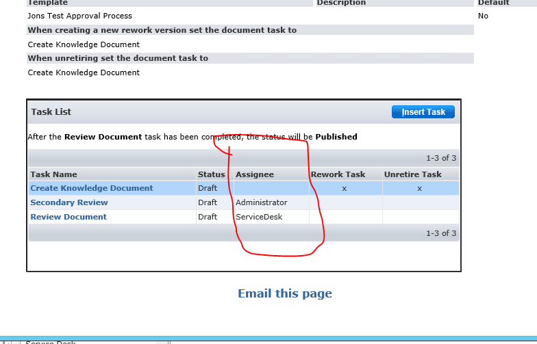

    4. The document also says that you can have a different Owner for each step of the approval process. In the approval process that I built, I am unable to define an owner at each step, so how is this done.
    ANSWER: You can do this when inserting tasks into your approval process, OR by updating tasks that exist - there is an assignee field on each task. You can assign those tasks to different contacts. Here is an example:
