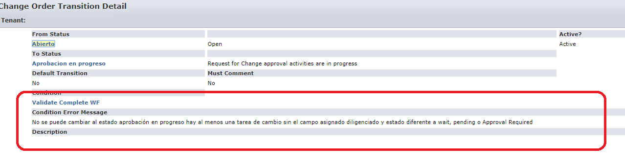

    Hello David,
    Actually I have a condition macro when the status of the change order pass from "Abierto" to "Aprobacion en Progreso"
    This is the code of the condition macro

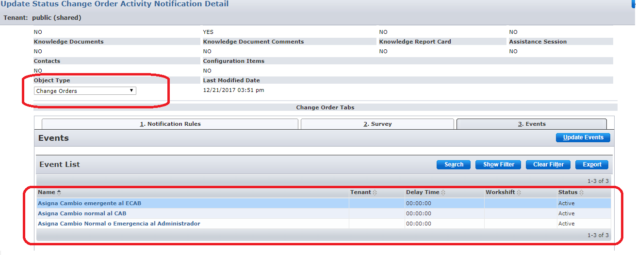

    then if the condition is true the change order pass to "Aprobacion en Progreso" and a evento is execute....
    the event execute an action macro to change the assigned and group.
    I want to do this using a button. It is possible or does not have any sense?

    Best Answer
    Posted Jan 16, 2018 11:02 AM
    Thanks for you Answer, I implemented a solution less intrusive. I have just simple open an activity update status page from the button.
