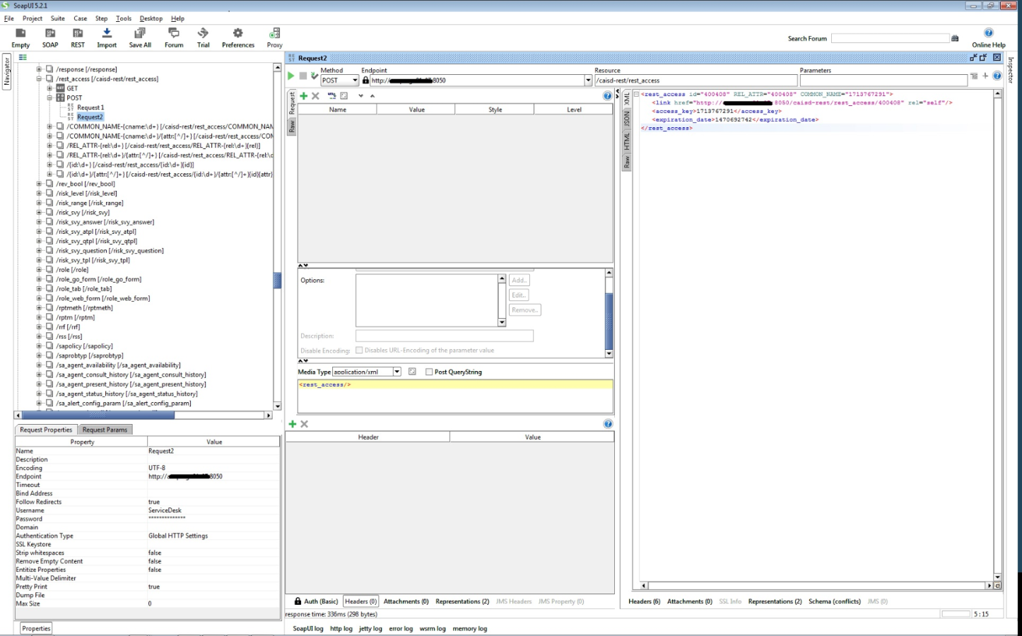

    Here is the screenshot from SoapUI:
    Hope it helps.
    Regards,
    Gordon.

    Hi,
    Now I'm able to obtain an access key. Thanks for your help.Gordon_Preston
