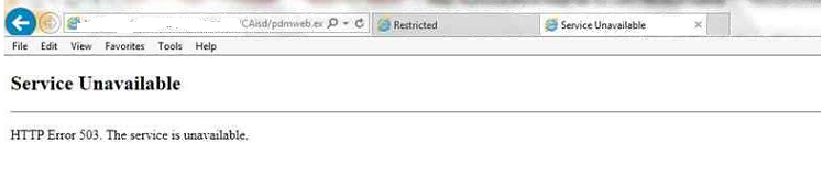

    Getting an issue that our application goes down too frequently with the HTTP 503 error &
    it gets resolved after performing iisreset.

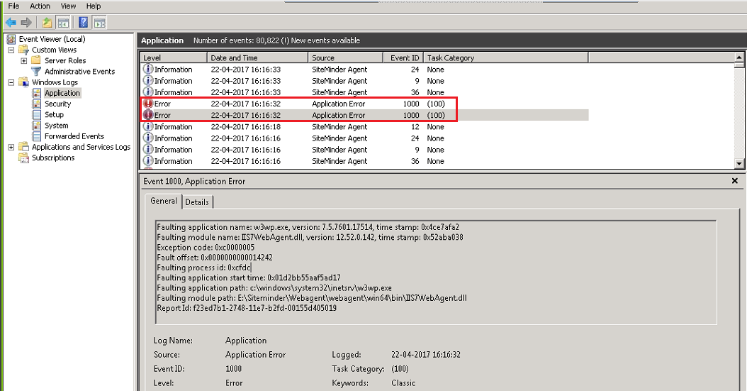

    When we have checked in the Event viewer, we found the below error which points the
    Faulting Module Path to the Siteminder.
    But we are not able to find any error in stdlogs at that specific instant.

    # What is the behavior of SDM URL access using tomcat i,e http://<Servername>:8080/CAisd/pdmweb.exe
    It's working fine on 8080 but with siteminder we are getting this error .

    As the crashing module appears to be the IISWebAgent7 module, which is a Siteminder module, I think we're better off getting the Siteminder team engaged on this one via a support case with that team.
