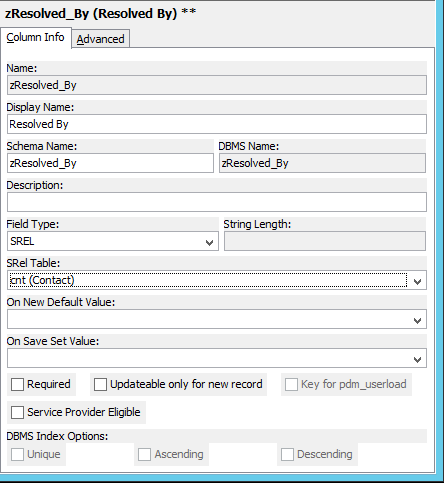

    Here are the steps to implement a customization which saves the Resolved By user to a custom zResolved_By column.  Can you explain how you would like to see the last comment displayed?  Would this be a specific activity type or the comment from resolving the ticket?
    1. Add zResolved_By to schema
    2. Save and Publish

    Your solution worked perfectly for me. Thanks for giving a straight answer. The comment is from when the analyst resolving the ticket. In the act_log the comment given when the status changed to resolved can be considered as the solution.
