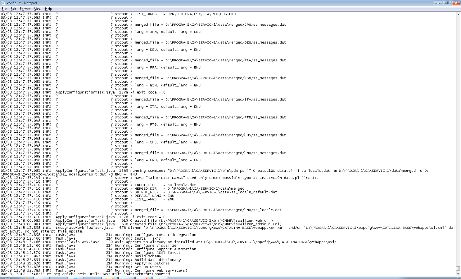

Hi Jon,

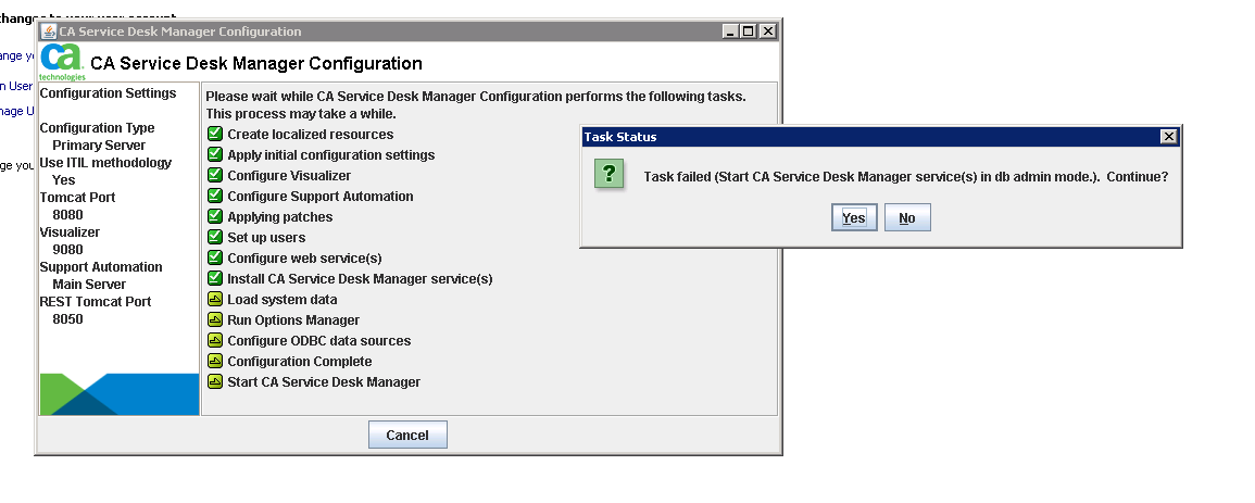

Our CASD version is 12.7 on a VM Server, and having a remote DB of MS SQL 2008 R2.
We have performed this migration activity today. CASD application server was cloned where host name remained same and IP Address got changed.
But when we run pdm_configure in the new server.we are getting Task Failed (Start CA Service Desk Manager service(s) in db admin mode.). Continue?

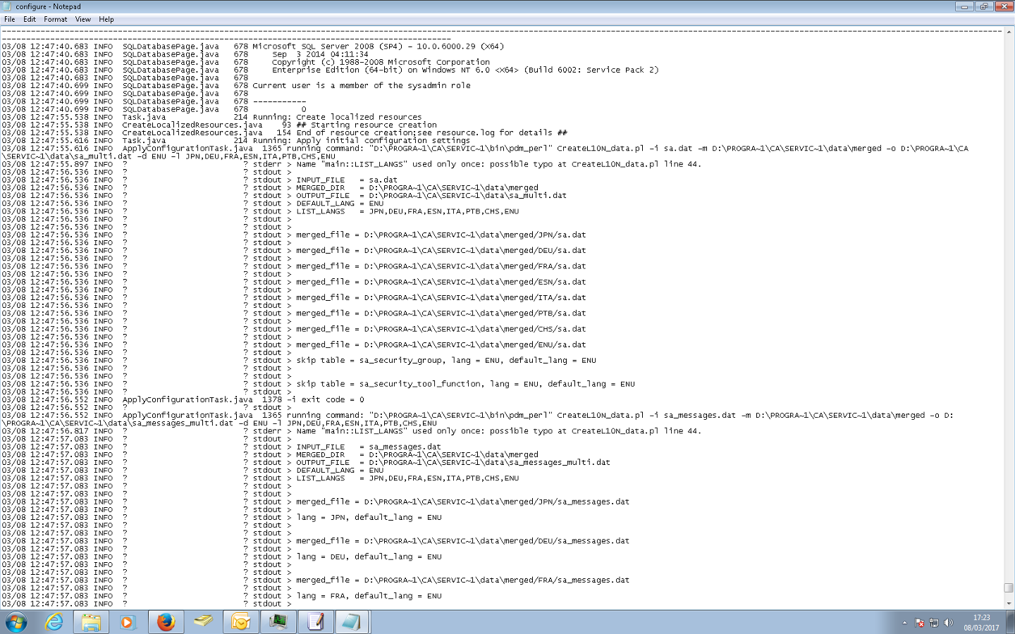

We tried connecting to DB through SQL Management studio from CASD Application server and that was successful. and the Userid used for connecting to DB was having sysadmin rights.
We tried pdm_d_mgr -u then again run pdm_configure but issue remained the same.

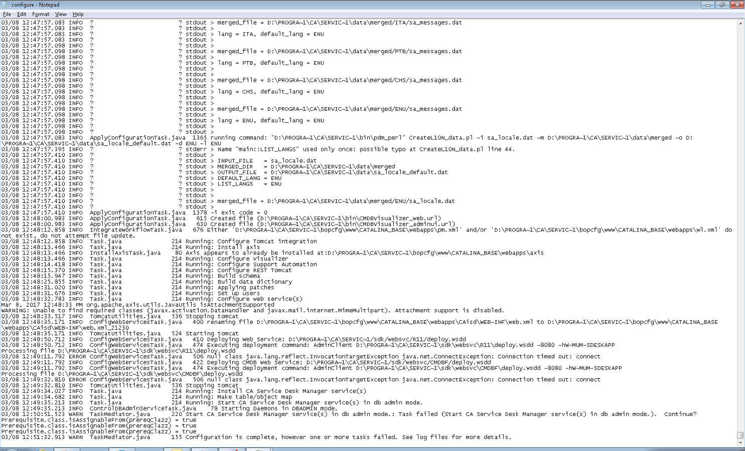

Below is the configure.log file snapshots:

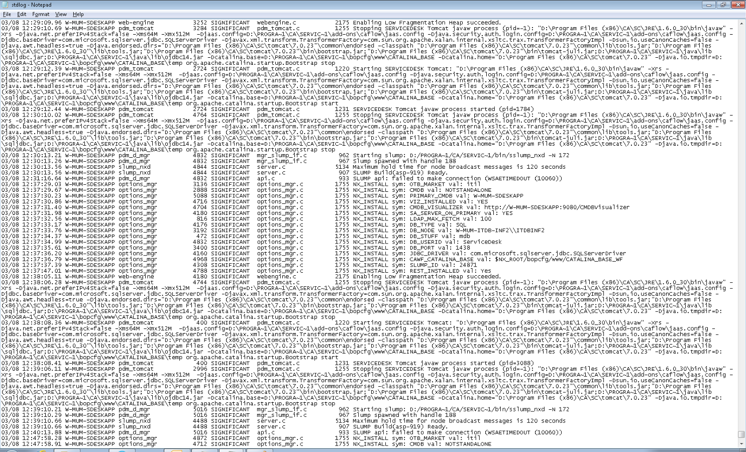

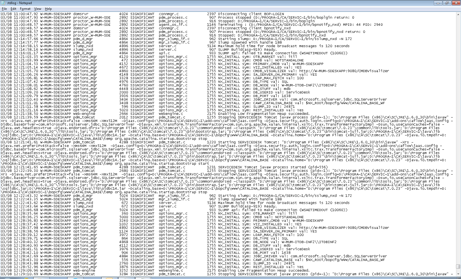

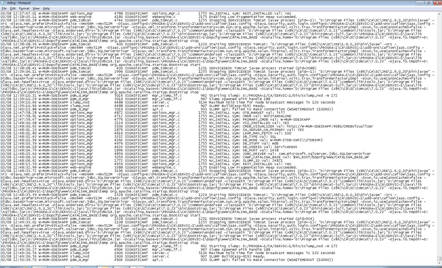

stdlogs are as below:
Please Assist
