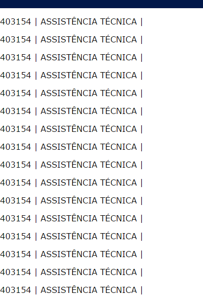

    when I run the code below happens as aprece in photo 1
    <PDM_LIST  PREFIX=list FACTORY=pcat WHERE="zContrato_ID = '400077'">
      ids = "<p>"  +ids +  "$list.id" + " | "+ "$list.sym" +   " | "+"</p>";
    </PDM_LIST>
    document.writeln( ids );

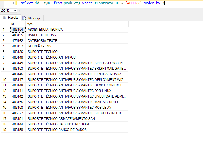

    but if I run a query in SQL Server the following result is shown
    question: how I move on to the next record in a PDM_LIST ?
    PS : I used PDM_LIST in other cases and never had this problem
    sorry for poor english

    Try this:
    ids="";
    <PDM_LIST  PREFIX=zlist FACTORY=pcat WHERE="zContrato_ID = '400077'">
      ids += "<p>$zlist.id | $zlist.sym |</p>";
    </PDM_LIST>
    Also, if zContrato_ID is defined as an integer then you should remove the ' ' surrounding 400077.

    It happened the same problem

    Refering to the first post, looks like you are running your query in another loop. could you share full code?

    The code ran perfectly on my detail_cr.htmpl file (except that my where clause was "cr_flag = 1").
    How is zContrato_ID defined on your pcat object?

    This is really strange, the only reason I can figure, that whereclause have appended with IN statement, which returns multiple rows of same data.
    Better way is to resolve rootcause of problem but workaround could be to push data in JavaScript array:
    listResult = {};
    <PDM_LIST  PREFIX=list  FACTORY=pcat  WHERE="zContrato_ID = '400077' ">
      someValue = "$list.sym";
      persidCat = "$list.persistent_id";
      if !(Number($list.id) in obj)
      obj[Number($list.id)] = "$list.sym";
    </PDM_LIST>
    for (key in listResult) {
      document.writeln('<p>' + key + ':' + listResult[key] + '</p>');
  • 8.  Re: PDM_LIST Problem
    Posted Jul 20, 2016 02:53 PM
    Thanks, this work for me!
