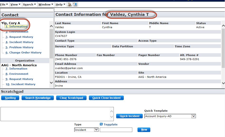

    Someone reported to me that sometimes after looking up a customer using the 'go resources' (example: customer by last name), and if there's more than one they select the appropriate contact from the list, the contact record displayed on the right pane of the Quick Profile screen is the one they selected, but the name on the left pane is someone else.  And when they click 'new' to create a ticket, it pulls in the contact record for the name shown on the left instead  (see screen print).
    I've not been able to reproduce it, and neither can the person who reported this.  She said it happens randomly.

    Try running the 'pdm_webcache -H' command and see how long it takes for the problem to come back.
    If it still comes back, I would advice you to reproduce it with the webengine, domsrvr and spelsrvr traces enabled and then log a Support Case with the trace logs attached for further investigation.
