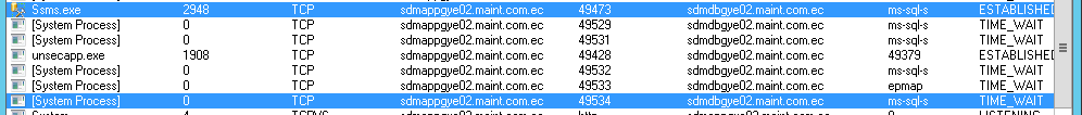

    I started checking the communication ports when running the wizard and found something strange:
    Everytime the wizard tells me that "Can't connect to the database mdb", the sdm server tries to communicate using a "[System Process]" to the db server without luck; but as you can see the port isn't closed, because I have the SQL Tools open and connected at the time I ran the wizard.
    Thanks!

    I found the following link: How to check the status of the database connection for Service Desk? and it fails, the reason was the password configured for the "sa" and "mdbadmin" accounts. Both of them had some special characters and I think it makes it too complex to use in SDM configuration.
    My recommendation to everybody is to avoid using "<" "$" "\" in the password of this users (don't know which of them exactly was causing the issue).
