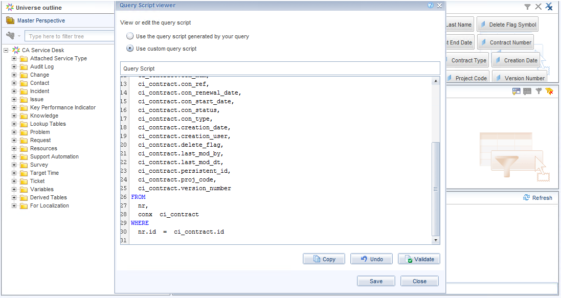

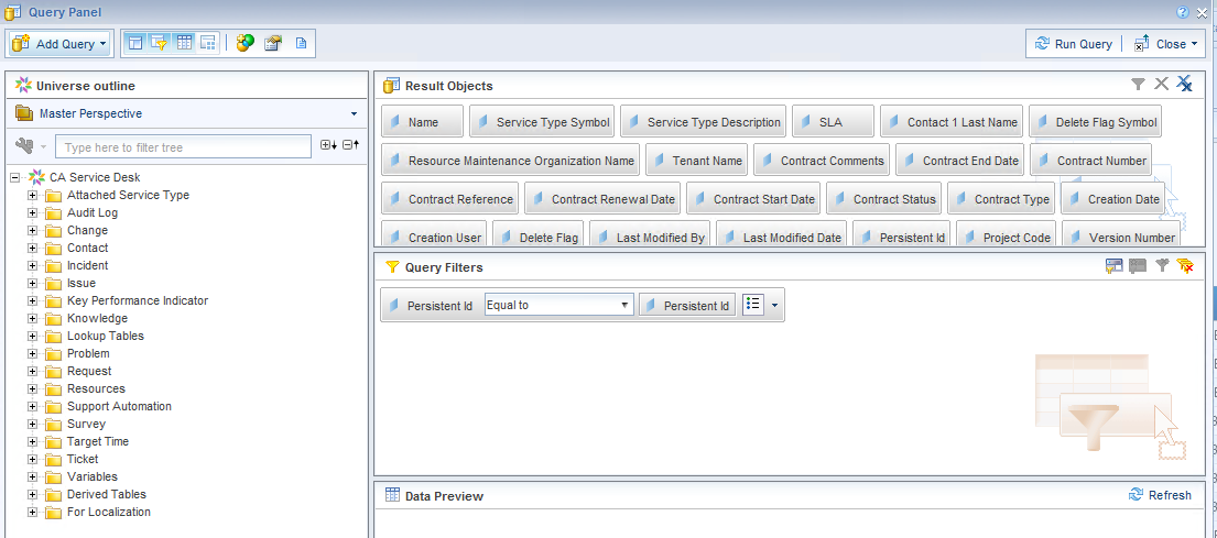

    Therefore you select some field where bring other table, how to find it?
    On query panel, last icon :
    You'll looking for "database select", can you see "alg" object/table?
    Do you see more object than cr/call_req?
    The fields are available on the same order than panel, try to remove some one where don't show cr object.
