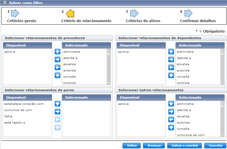

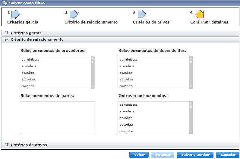

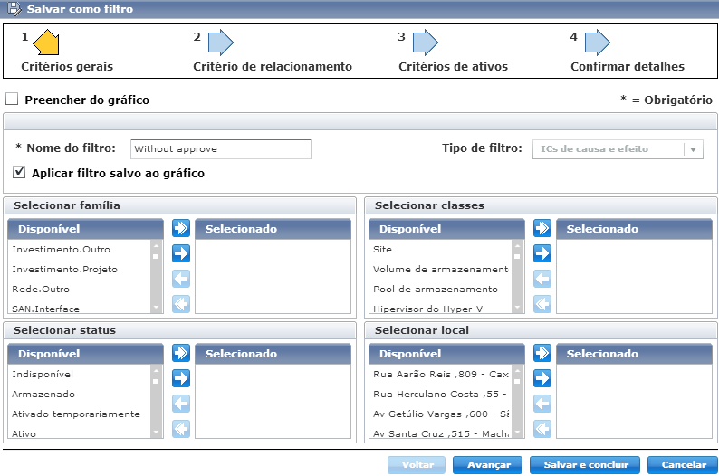

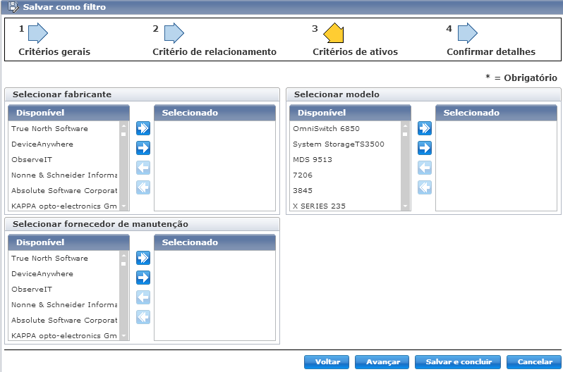

    I want to create a new filter that does not show one certain relationship type (approves).
    As defined in CMDB Visualizer Documentation, creating the custom filter according to Figures 1, 2, 3 and 4 should do the trick.
    Fig 1
    Fig 2
    Fig 3
    Fig 4
    After I finish the configuration, Tomcat and Visualizer Processes sometimes crash and the relationship "approves" between the two CIs is still shown.
    What am I missing? Is this some bug with SDM Visualizer? Tried this on 12.7 and 14.1 and the same problem happens.
