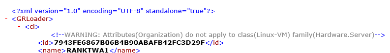

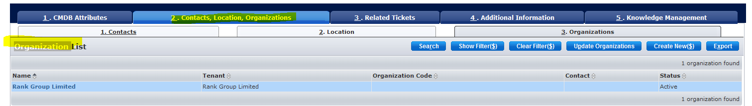

    Hi Im trying to find the table in R12.6
    that linked the CI with an Organization
    I have tried to attached these with Gloader but unsure if this will work as this will be a many to many
    which I may need to use the Pdm_load
    Im trying to find what table this is called
    or has anyone been able to do this via Grloader.
