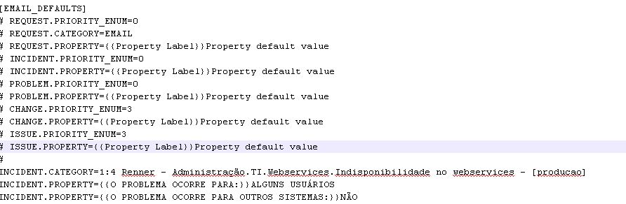

    I tried to set the category and the properties under the [EMAIL_DEFAULTS] on "text_api.cfg":
    Following exactly the same syntax, which's configured on the category:

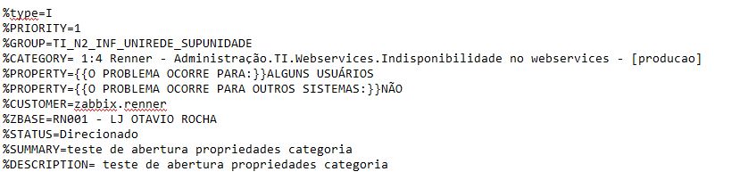

    And then, I set all the keywords at the email body:
