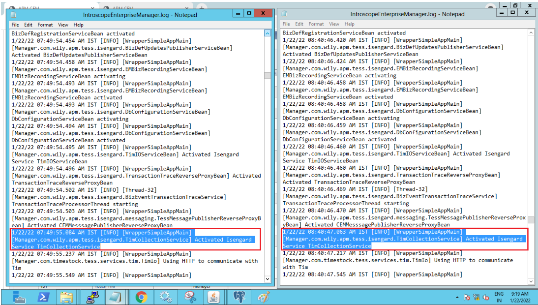

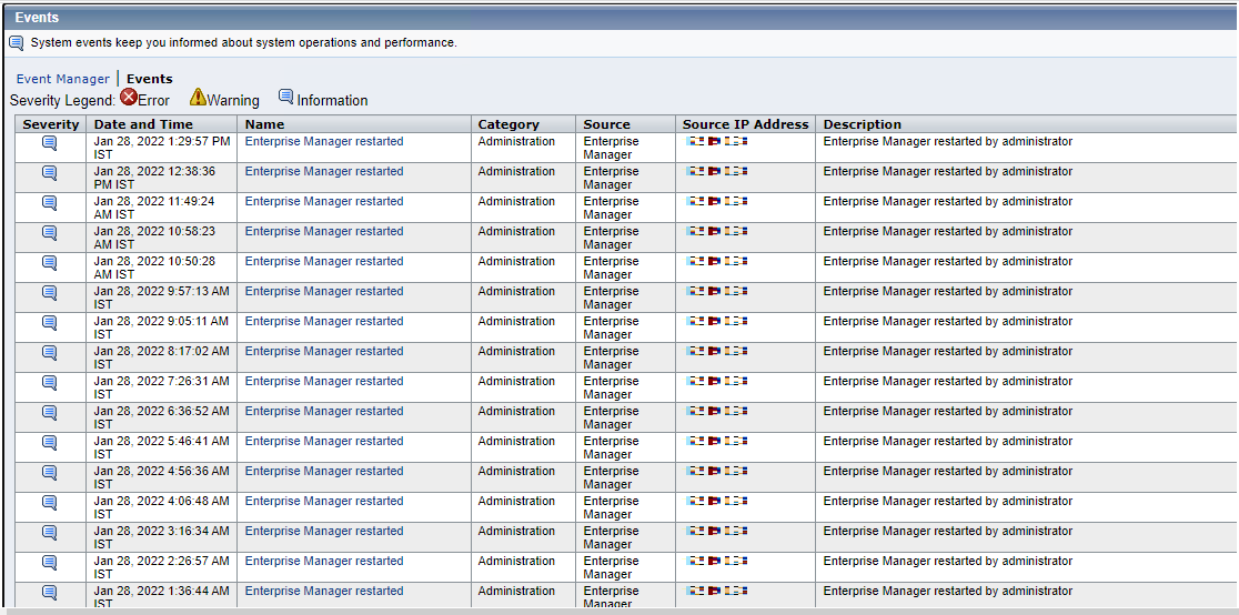

    Our MoM server crashes intermittently , service getting restarted on it's own & comes up.
    Didn't know exactly why this is happening . attaching logs & screenshot from the MoM Server & we are using APM 10.7.0.45 version .  Case has also been raised 32979151 with Broadcom.

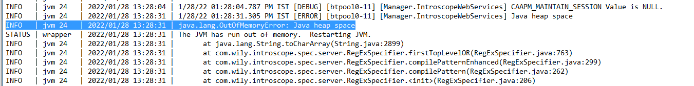

    No error is showing as of now in CEM, only error getting now is Enterprise manager restarted and with every instances of error in CEM getting log message java. lang.OutofMemoryError : Java heap space.
    1) I doubt if initial Java heap memory & maximum java heap memory  setting needs to be done .
    I see that we can change the value of wrapper.java.initmemory & wrapper.java.maxmemory in EMService.conf file. Current value set as below:
    # Initial Java Heap Size (in MB)
    wrapper.java.initmemory=4096
    # Maximum Java Heap Size (in MB)
    wrapper.java.maxmemory=10240
    2) Also i have seen one file is there SmartStorTools.bat.
    Edit JAVA_OPTS to increase the heap size if needed. Current value set as below:
    set JAVA_HOME=%INSTALLDIR%\jre
    set JAVA_OPTS=-Xmx512m
    Currently the value set to 512m should we increase or decrease to resolve Java heap space issue
    3) Also there is one another file Introscope_Enterprise_Manager.lax where i have seen option to set the lax java option additional values like Xms & Xmx setting.
     lax.nl.java.option.additional=-Xms8192m -Xmx8192m -Djava.awt.headless=false -Dmail.mime.charset=UTF-8 -Dorg.owasp.esapi.resources=./config/esapi -XX:+HeapDumpOnOutOfMemoryError -XX:HeapDumpPath=./logs/ -Xss512k
    Plz let me know the exact setting needs to be done to all these to resolve java heap space issue if we have 32GB of RAM available in the server .

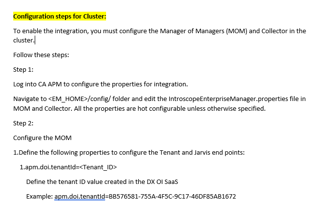

    I also found in the readme.txt , Configuration steps for the Cluster. So, does this step need to be done?
    If yes, when we need to do this before or after installing hotfix. PFA screenshot below. Also let me know is it to be done after applying the hotfix on all 3 servers i.e., including a MoM & an agent collector and TIM collector server .

    EM hotfixes must be applied to all EMs in a cluster
  • 7.  RE: Enterprise Manager restarted by administrator error in CEM , EM crashing
    Broadcom Employee
    Posted Feb 16, 2022 03:48 AM
    Hi SHiv,
    the Hotfix is to be applied on the EM (Collectors) and MoM only.
    From your explanation, you have one MoM, one EM (for Agents) and one EM for the TIM collection service. You have to apply the Hotfix to all these 3, and also on the machine (if separate) running the PostgreSQL Server.
    You also have 3 TIM's running. These do not need to have the Hotfix applied. If there are any Hotfixes for the TIMs,  it will come in a separate hotfix package.

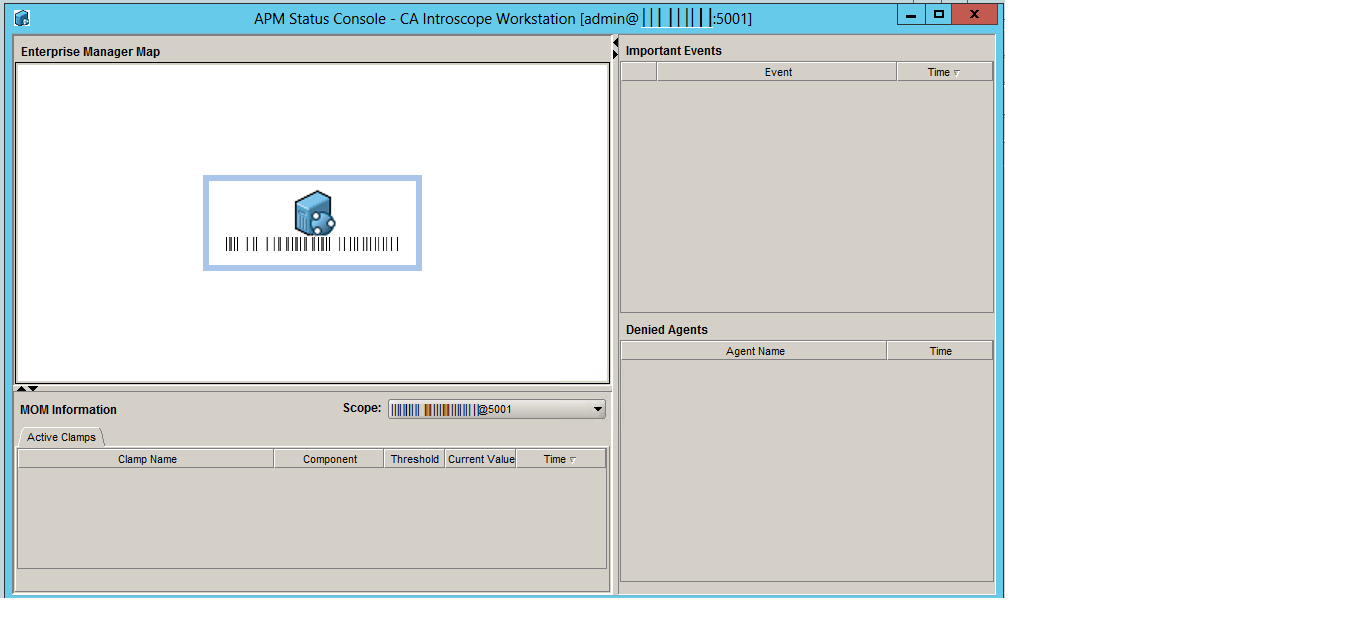

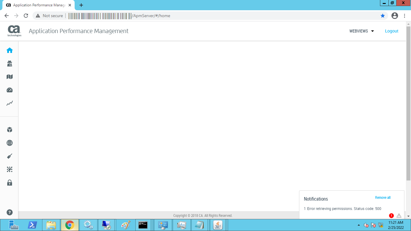

    getting below error in WebView 1. Error retrieving permissions. Status code: 500
    Enterprise Manager and WebView start up with no errors. But When logging into Enterprise Manager Team Center, seeing the following error in the IntroscopeWebview.log and there isn't any data showing up at all under metric view, agent view, map
    Also in New APM status console , collectors are not reflecting , I suspect it was due to not applying HF60 patch on collectors or due to some other issue . Also one of our Agent collector is on 10.5 & other TIM collector is on 10.7 version so how do we proceed ?
