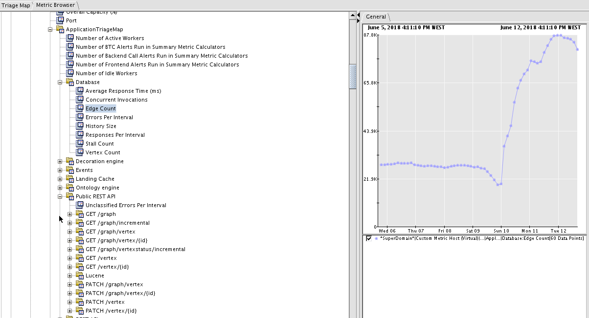

    We're experiencing slow performance on TeamCenter, sometimes it takes up to 20-30 secs to view groups of components in the map.

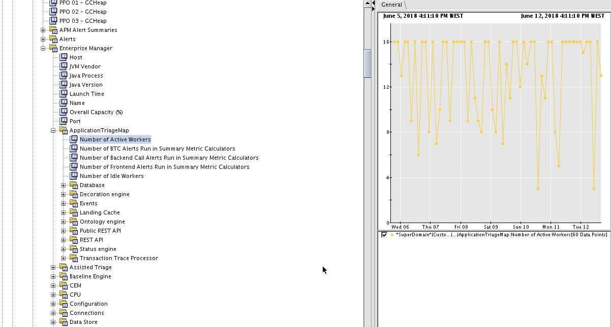

    1. Metric Name: Number of Active Workers Metric Path:
    Enterprise Manager|ApplicationTriageMap:Number of Active Workers What does it measure: Indicates how many threads are currently used from common thread pool of APM Team Center. It can point to overloading issues. The maximum value is 8 and it should be below 2 or 3.

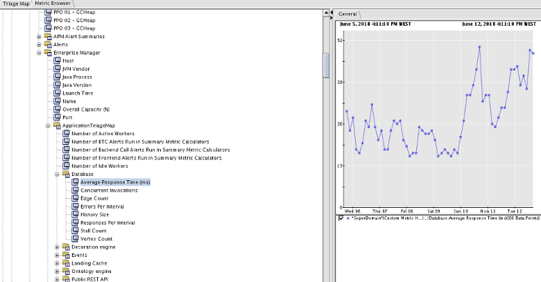

    2. Metric Name: Database:Average Response Time (ms) Metric Path:
    Enterprise Manager|ApplicationTriageMap|Database:Average Response Time (ms) What does it measure:
    Indicates what is the average time of data processing in APM Database for APM Team Center.
    It can point to a bad APM Database condition.

    4. Metric Name: Database:Edge Count Metric Path:
    Enterprise Manager|ApplicationTriageMap|Database:Edge Count What Does It Measure:
    Indicates how many dynamic changes we are tracking for topology of ATC in APM Database. It shows a size of environment. It grows up continuously because the Database stores expired entities as well.

    So we're guessing it's a database issue, as anyone experienced this kind of behaviour? What can we do in order to increase the performance on the database side ? We're attaching the images on a 7 day scale and you can see the degradation of the database as we add more and more correlation in the appmap.
