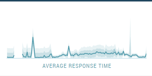

My problem: I couldn't see the grapichal result of Differential Analysis in Team Center in my production environment, meaning I only saw this:

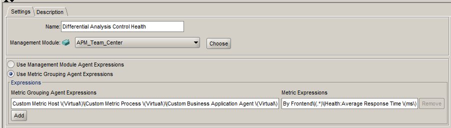

>>The graphical result of the differential analisys is only gave for frontend components and only if you set up a metric grouping as follow:
metric grouping agent expression: Custom Metric Host \(Virtual\)\|Custom Metric Process \(Virtual\)\|Custom Business Application Agent \(Virtual\)
metric expressions: By Frontend\|(.*)\|Health:Average Response Time \(ms\)
After you need to create a standard differential control and link it to this metric grouping and the job is done, you'll see this as a result:
This has worked for me, since before this config i was only seeing the straight line in blue, but I admit I only have 1,5 year experience with ca tecnologies products (APM, Spectrum, CEM and others..) and Team Center is the very new thing to play with (actually not to play with since there are a lot of expectation from it) so if you have something to contribute with or you notice wrong info that I provide you're more than welcome to join this thread.
