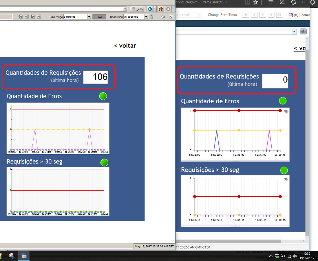

    I'll try to be more specific. What my custmer want me to do is to create a dashboard with 3 information.
    The first is show accumulated errors of the last hours (represented on the String Viewer graph).
    The second graph shows the live erros, the resolution is 15 second on every data point.
    The third graph shows the live stall count.The problem is on the Webview. When i set it up the String Viewer with one hour resolution it does not apply, but on the workstation works fine. I'' send you another screenshot on the same period.
    This picture show the same dashboard on the both console, on the left side is on the Workstation and the right side is the Webview. (I circled the graph with the problem)
    Thank you for your attention.

    If you put Workstation into historical mode, does the value also go to 0?  String Viewer metrics will show live but will show "no data" when put into historical mode.  Can you verify if this is what you are doing?

    Hi musma,
    Yes, when I put on historical mode the String Viewer show "no data"
    But the point is they will not use this dashboard in historical mode, only live mode, that's why I have to put the error from last hour on the same dashboard with the last 8 min graphs.

    Hi Thiago,
    I have verified this on my own 10.5.1 environment.  Workstation is allowing you to stay Live and change the Resolution.  In WebView, the only way to change the resolution is to go to Historical mode.

    Hi Matt,
    Thank you for the answer.
    So this is a limitation of the WebView?
    Do you have any suggestion how to work around this issue?
    Thanks
    Thiago Anate

    Hi Thiago,
    Yes it is a limitation on WebView.
    The only workaround is to use Workstation, or use the standard resolution in Live view on WebView.
    My other suggestion would be to create an Idea on the community here to have the same functionality added into WebView.  This way our Product Management can review it.
