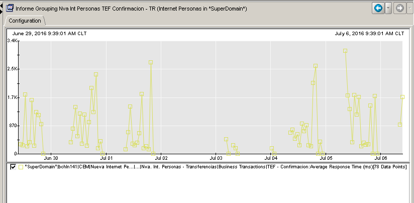

    Then, as I understand it, increase this value in the ranges defined in the documentation, I would allow EM take longer to stop listening to the metric having no such activity.
    Visually this inactivity is reflected in gaps in the charts of metric?
    Our client is uncomfortable with the gaps in the graphics, as in the previous version were displayed values 0
    If I modify this attribute, I can obtain a plus in the metrics  displayed ?
