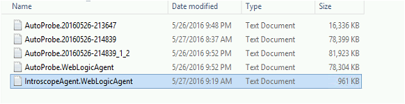

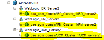

    The following property work perfectly in non-prod
    introscope.agent.agentName=WebLogicAgent

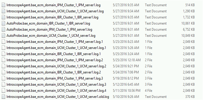

    Also, logs are being written separately (in non-prod):
    But in prod the above property does not work.
    The logs are not being written separately (in prod)
    Not sure why it's not working in prod env. I've checked permission issues and that's not contributing. Same admin privileged service account is used in both environments to install the agent.
