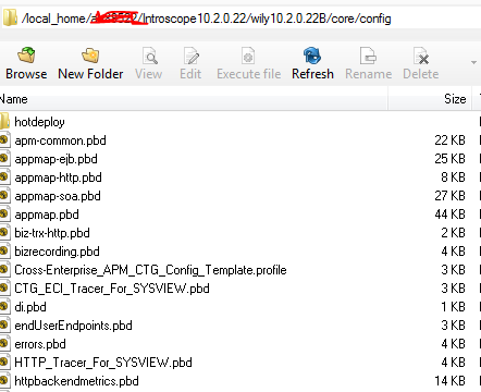

    This is a Unix/Linux agent and all assets were loaded from the support site. Currently, we are not including Browser Agent on our standard agent so I did an install on a Linux box specifying that I did not want Browser Agent installed. On this agent I have no Browser Agent assets in the examples directory.
    I then created an agent (using the same 10.2 bin file) and specified that I wanted to accept the Browser Agent. This ends up with the assets for ext and js being put in and the profile and webshere-typical.pbl modified as above. But again, I do not see the browseragent.pbd in the config directory:
    Also there is no assets in the example directory for APM/BrowserAgent so I cannot pull it from there.
    I do see the BroswerAgent assets in the noinstaller examples but this also does not include the browseragent.pbd
    So maybe there is a newer version out on the support site since I downloaded this the day that 10.2 GA'd.
    I will try that

  • 5.  Re: Can't Find browseragent.pbd
    Posted Aug 19, 2016 03:00 PM
    I had not looked in the noinstaller config dir (since I thought it would be in the examples) but there I do see the browseragent.pbd. So I can copy that over into agent directory that has the Browser agent installed and re-tar up the distribution tar...
