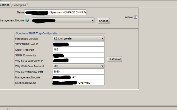

    Here is the Spectrum Action.

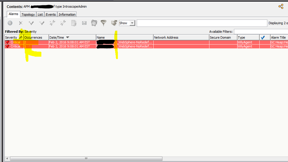

    Here is an test alert, we set the thresholds low so that it triggers.
    So we would expect to get 1 alert for each server/JVM (02Node01, 01Node01, 03Node01); however, 2 alerts are tied to one model, and 1 alert to the other.
    In capturing a TCPDUMP, we can see that the agent names are in fact the models in Spectrum; thus, it may be that APM is sending the wrong agent name in the trap.  If anyone else is facing this isse, please let us know.

    However in reading your other update, you have notify by individual metric checked.  You also have the trigger "whenever severity changes".  So in your test above, if one metric goes above 70, the alert will be sent to Spectrum.  And that is fine.  Now when that same metric goes below 70, a clear will be sent to Spectrum to clear the event.  However, if metric A from Agent A goes above 70 and generates a critical alert on Spectrum, it will stay there until it is cleared.  So let's say 1 minute passes after metric A went above 70.  Now metric B from Agent A goes above 70, thus generating another critical alert to Spectrum, then you will see 2 critical alerts in Spectrum from Agent A.

    Thank you for your response.  We did enable debug to see the bindings and the issue is around the fact that there should be a total of 3 total Critical Alerts: one for each JVM.  However, the var bindings are showing them as going to one agent.
