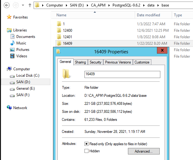

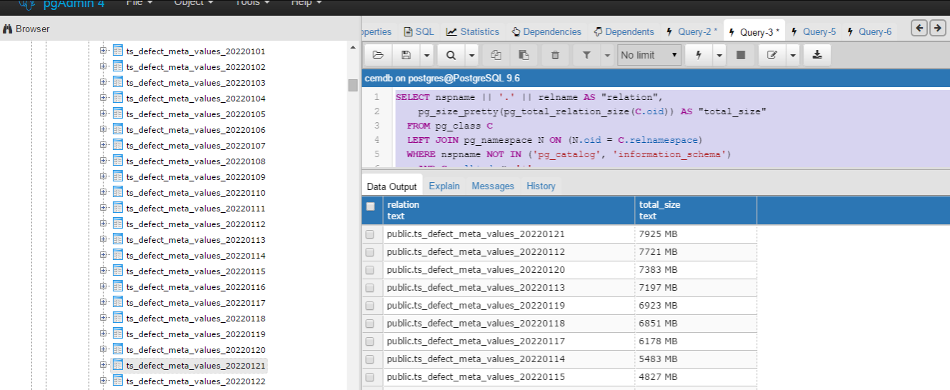

    We were facing error in one of our TIM server as the Worker XX folder under defects directory consuming lots of space . we have removed the files from the worker & noticed that our MOM is heavily loaded with defects data & the Database size is increasing at an alarming rate .
    huge number of defects data started creating in DB and we are running out of space due to this. I have observed database size increase by 10GB in a day.
    Please help me as i can't find any exact solution from Broadcom too . For this case 32989022 is also raised. PFB Screenshot for more clarity .

    this is probably happening because of what we call a Defect Storm.
    Now that you have eliminated the condition where the collector wasn't able to collect the defects, it is now processing all that he got (also the old one) and tries to aggregate them all at the same time.
    You have 2 possibilities:
    1. Wait until the collector calms down and is able to also age out old defects. The data retention settings will control this over time. But you will need to have space for the database in the meantime.
    2. stop the collector and the TIM. Delete all defects on the TIM (Do not touch the statistics files themselves) that are in the out-queue. Clean up the collector directories (where it stores the defects to process) then restart the TIM and the collector.
