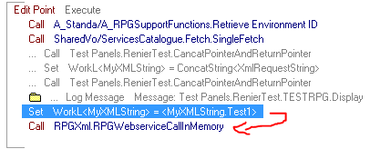

This is in "Program A" : this program is responsible for building the request, in this plex function(RPGIV) I created a new field in WorkL called "MyXMLString" in the source code I modified it to be based on a pointer.
Now in "Program A" I am setting or appending the XML in to "MyXMLString"
Where MyXMLString.Test1 is a valid xml request just for testing purpose.

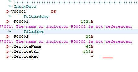

I defined the iServiceReq as a pointer.
Then I also defined the following.

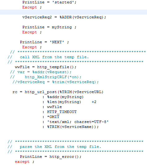

I define a string or field in memory that will be send into http_url_post
Next I move the the input in to my working variables.
In my free format I set myString pointers address to the input address vServiceReq.
I then consume the webservice using myString address as my post data.

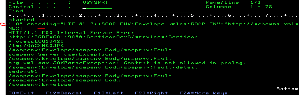

When I run Program A and view my spoolfile to check the print statements I get the following.
So I am guessing its sort of working except its cutting off the start of my xml string.
