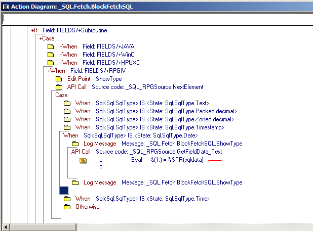

    1. On our screens we are using a SQLBlockfetch pattern that we found here : http://wiki.plexinfo.net/index.php?title=My_BlockFetch_dynamically_using_SQL
    When viewing the job log after the sqlblockfetch has run we get the following error or log on the green screen.
    Where  P68EAF is the sqlblockfetch. and the statement before the error is a log I put in to view the data that its trying to cast.
    In the sqlblockfetch the api gets the data and casts it to a textfield.
    The  parameter &(1:) is a textfield.
    Now at this stage no error gets printed, the next step the sql blockfetch casts the textfield with the value '2013-05-2300' into the field thats in the view (CheckedDateISO) field.
    This is where the job log gives that error as in the joblog image. And I have noticed that its normally a Date that does this.
    The field that its trying to cast it to is a CheckedDateISO
    I think it as something to do with the date format or the way it gets handled in plex 7.2 What changed?

    The only program that we got in the ptf or patch PTF721.024.001 was YOBCASTAEX. but in my example wont it use YOBCASTNEX?  I am casting with meta code '2013-05-2300' a text field to a date field.
