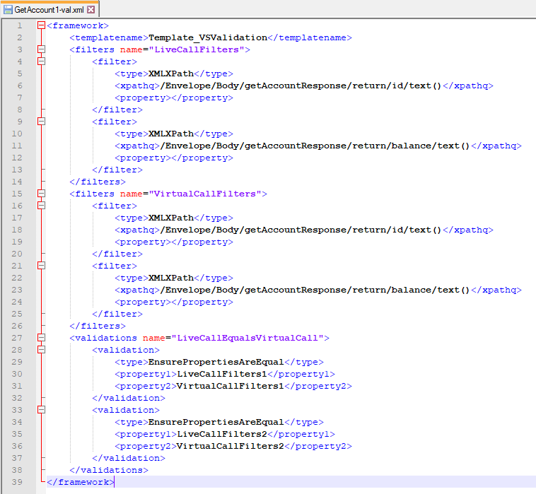

    The definition of such a test suite would be done completely by editing some files in a directory, it would look something like this:
    The -req.xml files would contain a request to be sent to the API, it would look something like this:
    The -val.xml files would contain the definition of the filters and assertions as they would be defined/required by the "Template_APITest" template, it would look something like this:

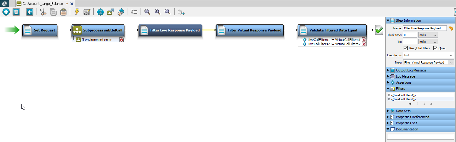

    After creating a test definition like above for every test you want to generate, we would run a batch file which eventually would use testrunner to execute another test - i.e. CreateTestV3 - which would write out a .tst file for every pair of -req.xml + -val.xml file.
    The generated testcase would look like:
    The actual API calls are done inside a subprocess (doesn't have to be but here that is how the template is built). I selected the "Filter Live Response Payload" step, you can see it has 2 filters created (those are the ones defined in the "LiveCallFilters" Filters element of the -val.xml file. You can see the 2 assertions created in the final "Validate Filtered Data Equal".
    So, the above is the long answer, the short answer to your question is 'yes, this is achievable'.
