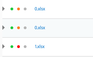

    So, my results in backend system are:
    Here 0 & 1 are instances. When i staged, the results should be 1,2,0 .. but same instance is being repeated
