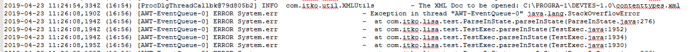

    I'm unable to save this file , the workstation is getting hanged when try to save. I have checked the workstation.log and observed stackover flow error.
    2019-04-23 11:26:08,190Z (16:56) [AWT-EventQueue-0] ERROR System.err - Exception in thread "AWT-EventQueue-0" java.lang.StackOverflowError
    2019-04-23 11:26:08,194Z (16:56) [AWT-EventQueue-0] ERROR System.err - at com.itko.lisa.test.ParseInState.parseInState(ParseInState.java:276)
    2019-04-23 11:26:08,194Z (16:56) [AWT-EventQueue-0] ERROR System.err - at com.itko.lisa.test.TestExec.parseInState(TestExec.java:1952)
    2019-04-23 11:26:08,194Z (16:56) [AWT-EventQueue-0] ERROR System.err - at com.itko.lisa.test.TestExec.parseInState(TestExec.java:1934)
    2019-04-23 11:26:08,195Z (16:56) [AWT-EventQueue-0] ERROR System.err - at com.itko.lisa.test.TestExec.parseInState(TestExec.java:1930)
    I have also tried to increase the stack memory to 4MB but still facing the issue.

    You can comment out -Xss setting, restart workstation and retry.

    Posted Apr 25, 2019 02:24 AM
    Hi All,
    I have used -Xss to increase the thread stack size.
    The issue is resolved now, Issue is because of having one property name substituted as {{{{test_filter}}}} instead of {{test_filter}} in parse text as response step by mistake.
    It might be going to infinite loop in validate this xml and getting stack overflow error.
