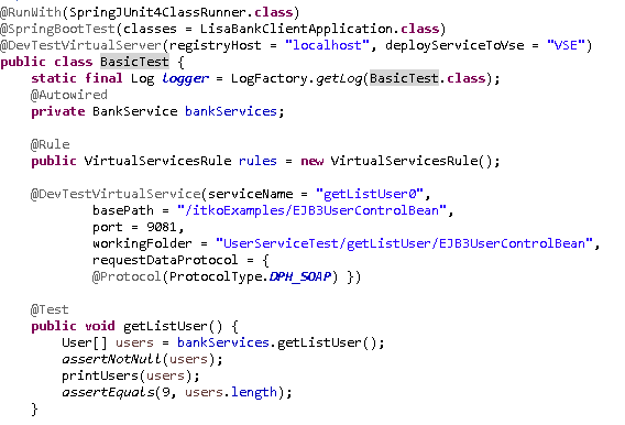

    An example of how to use the annotations is as as given below.
    DevTestVirtualServer annotation lets you define the registryHost (local by default), VSE name (VSE by default), username (svpower by default) and password (svpower by default).
    The VirtualServices rule defined will handle the SV-as-Code annotations during the Junit lifecycle.

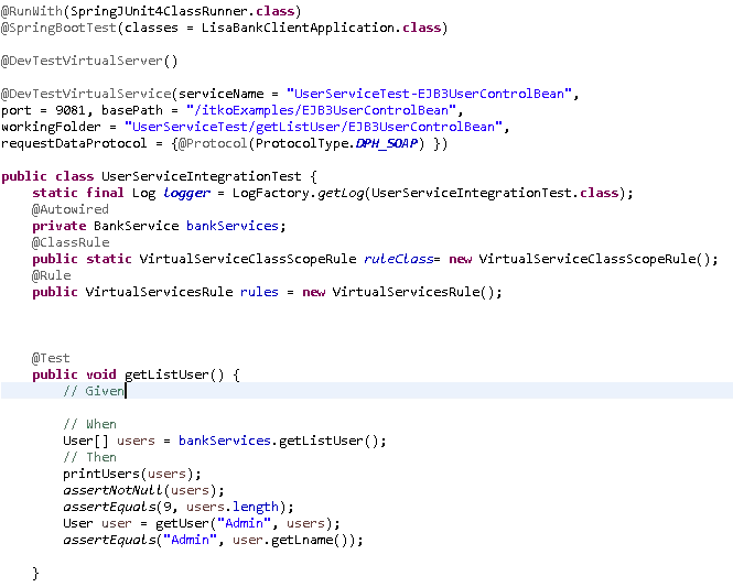

    The next annotation DevTestVirtualService which needs to be added above each test definition, lets you define the virtual service by providing the serviceName, basePath for the service, port for the service, working folder (which is the folder where rr pairs, vrs file, vsm file etc. are present), requestDataProtocol (defines the data protocol to be used to process transactions).
    In addition to defining virtual services at test level, they can be defined at a class level, which will be deployed once at class level. That will use a ClassRule named VirtualServiceClassScopeRule as shown below. This will let us defined DevTestVirtualService annotation outside the class as shown below.
