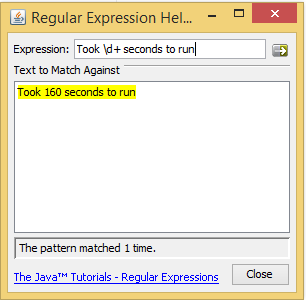

    Can any one let me know how to use ensure result contain expression \assertion
    In my response I am having string as "Took 140 seconds to run"  number will change for each run so I have marked \d+
    is it correct ?
    Or expression I have to right something like ^Took \d+ seconds to run$, but this one is failing even my response have that string.
    Both the expression are working in helper
    1)
    2)
    My only concern is which is correct 1 or 2 screen shot, When I tried to applied  the 1st one in assertion itss getting failed but second one is working for me but not sure whether is correct  or not.
    anyone can explain me this with example, that will help a lot.

    I validated both at Online regex tester and debugger: PHP, PCRE, Python, Golang and JavaScript and both worked.
    I am not sure what the implementation in DevTest. If the second one is working in DevTest. I would recommend using that.

    I just wanted to know, How we need to write the expression in Dev Test ?
    I mean to say expression need to be written under {{}}} or () or simply right the statement as I mentioned in earlier example
