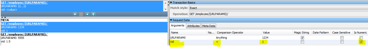

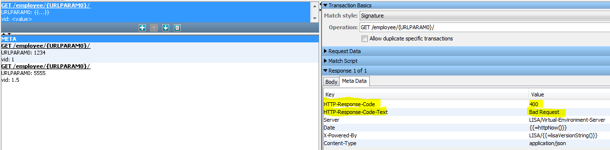

    The following might be oversimplified. One approach is to use the VSI's Comparison Operator to send a response.
    1) In the VSI, assign the 'vid' as a numeric

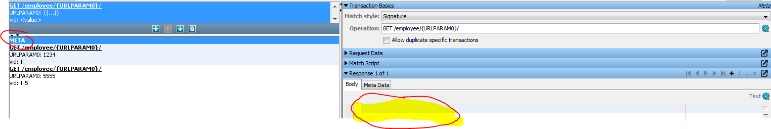

    2) Allow META to respond with the HTTP 400 Bad Response
    Body is empty
    Meta Data has HTTP 400 Bad Response
    3) Create two specific transactions.
    In the first specific txn, the comparison is vid <1 (response for all VID values less than 1)
    In the second specific txn, the comparison is vid >= 1.5 (response for VIDs greater than 1.5)

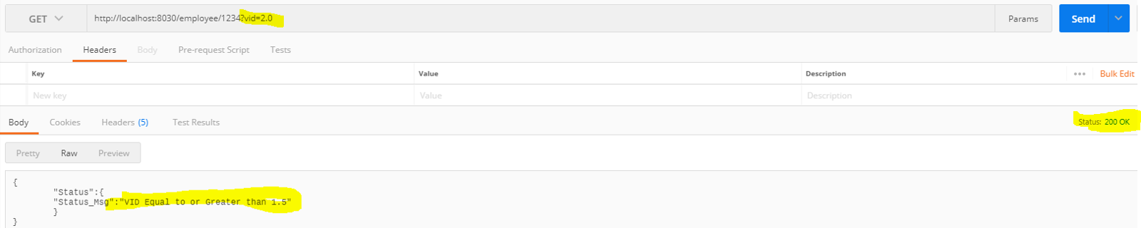

    Running the test from Postman:
