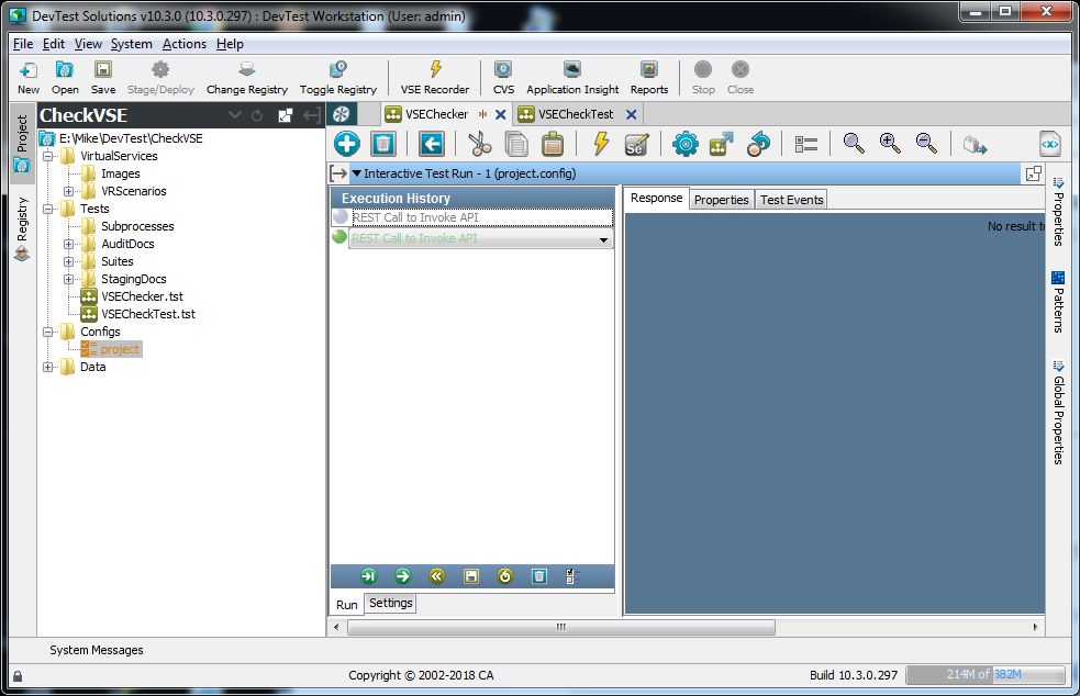

    Both of your test cases look good and I'm seeing a response.
    When you're not seeing a response, are you running the test in ITR?  In other words, are you seeing a screen like this?
    If this is what you're talking about, then you're encountering a UI bug - I've seen this behavior before.  You see a response the first time you run the test, but not after you reset the session and run it again.  I suggest ending the ITR session with the trash can icon and then opening a new one.
    On the other hand, have I simply misunderstood your question?
    --Mike

    Yes Mike_Gavaghan , I'm running in ITR mode and getting the below error. Please find the below and attached the error for reference.
    ============================================================================ | HTTP ============================================================================ | Step: REST Call to Invoke API ---------------------------------------------------------------------------- | Message: javax.net.ssl.SSLException: Received fatal alert: unexpected_message ---------------------------------------------------------------------------- | Trapped Exception: Received fatal alert: unexpected_message | Trapped Message: javax.net.ssl.SSLException: Received fatal alert: unexpected_message ---------------------------------------------------------------------------- STACK TRACE javax.net.ssl.SSLException: Received fatal alert: unexpected_message at sun.security.ssl.Alerts.getSSLException(Alerts.java:208) at sun.security.ssl.Alerts.getSSLException(Alerts.java:154) at sun.security.ssl.SSLSocketImpl.recvAlert(SSLSocketImpl.java:2023) at sun.security.ssl.SSLSocketImpl.readRecord(SSLSocketImpl.java:1125) at sun.security.ssl.SSLSocketImpl.performInitialHandshake(SSLSocketImpl.java:1375) at sun.security.ssl.SSLSocketImpl.startHandshake(SSLSocketImpl.java:1403) at sun.security.ssl.SSLSocketImpl.startHandshake(SSLSocketImpl.java:1387) at org.apache.http.conn.ssl.SSLSocketFactory.connectSocket(SSLSocketFactory.java:535) at org.apache.http.conn.ssl.SSLSocketFactory.connectSocket(SSLSocketFactory.java:403) at org.apache.http.impl.conn.DefaultClientConnectionOperator.openConnection(DefaultClientConnectionOperator.java:177) at org.apache.http.impl.conn.ManagedClientConnectionImpl.open(ManagedClientConnectionImpl.java:304) at org.apache.http.impl.client.DefaultRequestDirector.tryConnect(DefaultRequestDirector.java:611) at org.apache.http.impl.client.DefaultRequestDirector.execute(DefaultRequestDirector.java:446) at org.apache.http.impl.client.AbstractHttpClient.doExecute(AbstractHttpClient.java:863) at org.apache.http.impl.client.CloseableHttpClient.execute(CloseableHttpClient.java:72) at com.itko.lisa.test.CommTrans.doSend(CommTrans.java:1074) at com.itko.lisa.test.CommTrans.send(CommTrans.java:843) at com.itko.lisa.test.CommTrans.sendGET(CommTrans.java:767) at com.itko.lisa.ws.rest.RESTNode.doSend(RESTNode.java:221) at com.itko.lisa.ws.rest.RESTNode.doWebTrans(RESTNode.java:171) at com.itko.lisa.ws.rest.RESTNodeBase.execute(RESTNodeBase.java:380) at com.itko.lisa.test.TestNode.executeNode(TestNode.java:984) at com.itko.lisa.test.TestCase.execute(TestCase.java:1297) at com.itko.lisa.test.TestCase.execute(TestCase.java:1198) at com.itko.lisa.test.TestCase.executeNextNode(TestCase.java:1183) at com.itko.lisa.editor.WalkThruPanel.prepAndExecNode(WalkThruPanel.java:1115) at com.itko.lisa.editor.WalkThruPanel.access$900(WalkThruPanel.java:73) at com.itko.lisa.editor.WalkThruPanel$10.doCallback(WalkThruPanel.java:1017) at com.itko.util.swing.panels.ProcessingDialog$2.run(ProcessingDialog.java:195) at java.lang.Thread.run(Thread.java:745) ============================================================================

    Okay, now I understand.  There's some conflict between how the client and server are negotiating the SSL connection.  This is strange because they're both DevTest components.  You can try adding these two settings to Workstation.vmoptions:
    -Dcom.sun.net.ssl.enableECC=false
    -Djsse.enableSNIExtension=false
    If that doesn't fix your problem, I suggest opening a support case.
