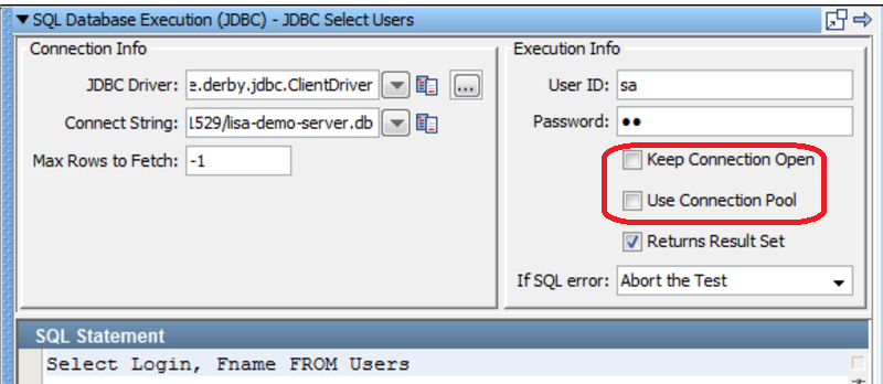

        Thanks for sharing the details. I have noticed similar issue before, when I run test through Jenkins. Can you please try by uncheck the  check boxes "Use Connection poll" and "keep connections open" options are  in JDBC exectuion step, so that when you run through Jenkins, it will establish a new connection and connect to database.

    I tried the above suggestion, however no luck
    Note:-Same error is thrown "java.sql.SQLException: Connections could not be acquired from the underlying database! ", when the Test Cases are staged locally or run against the Registry.
