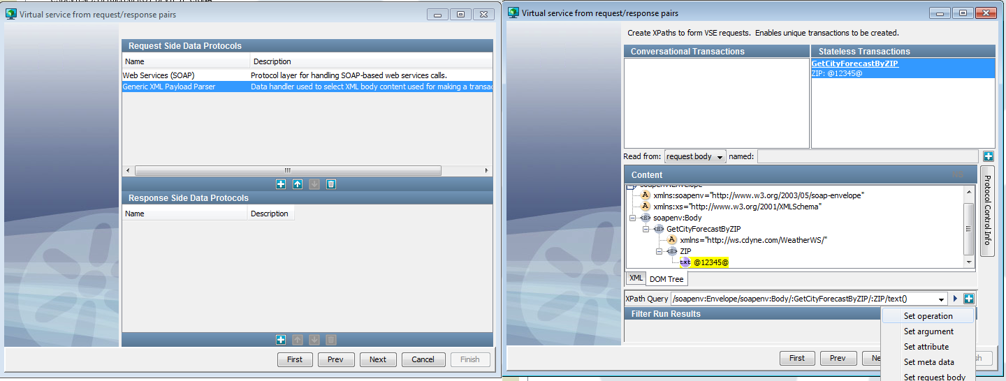

    Hello,
            You can use the Generic XML Payload Parser handler in addition to SOAP and select the field that you would like to set as operation name in that. Please find a screenshot below for that. Please let me know if this works for you.
    Thanks,
    Surya

    Hello Julien,
     If you see in the example I shared, I selected the ZIP field (tag) value under txt and not the field (tag) itself. In your case, please let me know what  you are trying to set as operation Name.
