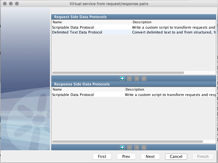

    In the absence of a data protocol built for your particular message format, you can use some Scriptable Data Protocols that will convert your RR pairs to something that passes for text, and then reverse that conversion at playback time.
    On the Data Protocol selection screen, add a Scriptable Data Protocol then the Delimited Text Data Protocol on the request side.  Add another Scriptable Data Protocol on the response side.  It should look like this:
    Next, you will be asked to configure those data protocols.  The first Scriptable Data Protocol should have a single 'Request' tab.  Put the following code in there:

    See if that works for you.  At the end of the recording session, make sure to use the little save button in the lower right corner because you do not want to enter all that again from scratch.
  • 9.  Re: Will the special characters in JMS Input message body be truncated in VS?
    Posted Aug 31, 2017 05:50 AM
    Greetings Kevin,
    Thanks for the quick reply.
    Your solution is working like a charm ....
    Good day!!!
