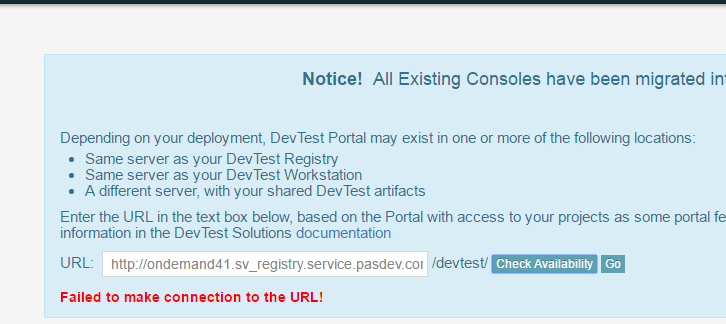

    Hi I recently, split up the devtest portal from the registry. We are upgrading from DevTest 8.5 to 10. Previously we were using the console, and now the portal has to be introduced. Because the Portal is on a different server than the registry, the URL in the screenshot below is incorrect, when trying to access old console (port 1505). My question is, how can I update this value? Is there a property that controls this? We are using Docker, so I would like to pass it in at startup. In our environment, registry are spun up on the fly, so manually updating this string won't work, since its not persistent.

    Hi Marcy, I don't think this will resolve my issue. I actually have the portal connected to the registry. The portal is working as expected. The issue I am seeing, is that this text field when browsing to port 1505, is displaying the DNS name used in the lisa.registryName parameter. This is wrong because the portal is on a different server, with a different DNS. I cleared the text box for the purposes of not displaying any private information. In the following instructions, all I see is that we are setting the registry values. I need to set the hostname of the portal. I did some research and found port 1505 is being served up by the registry docker container.

    When I browse to svregistry.mycompany.com:1505, the text field URL is displaying svregistry.mycompany.com:1507. This is wrong because the portal doesnt exist on the registry server. It should display: svportal.mycompany.com:1507. In the provided solution, I do not see anywhere to set this string. There should be a property called lisa.portalname or phoenix.hostname but I cannot identify a property that matches this.
    It's not a major issue, as I can manually go to svportal.mycompany.com:1507 but it is a problem because when someone clicks check availability or go link, it fails.
    Here are the  screenshots. ondemand41.sv_registry.service.pasdev.consul:2010 is the registry server. But the URL field has the same value. Instead I need it to be ondemand41.sv_portalservice.pasdev.consul

    Posted Mar 03, 2017 09:33 AM
    I found a workaround for this. I was putting the IP in directly in registry name. Instead I bounded the components to our NetScaler VPX (LoadBalancer). Using a VIP, when requests come in to 1507, I forwarded to the portal. Since, in that text field it inserts the port, this works.
