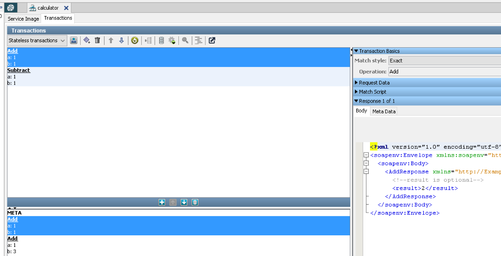

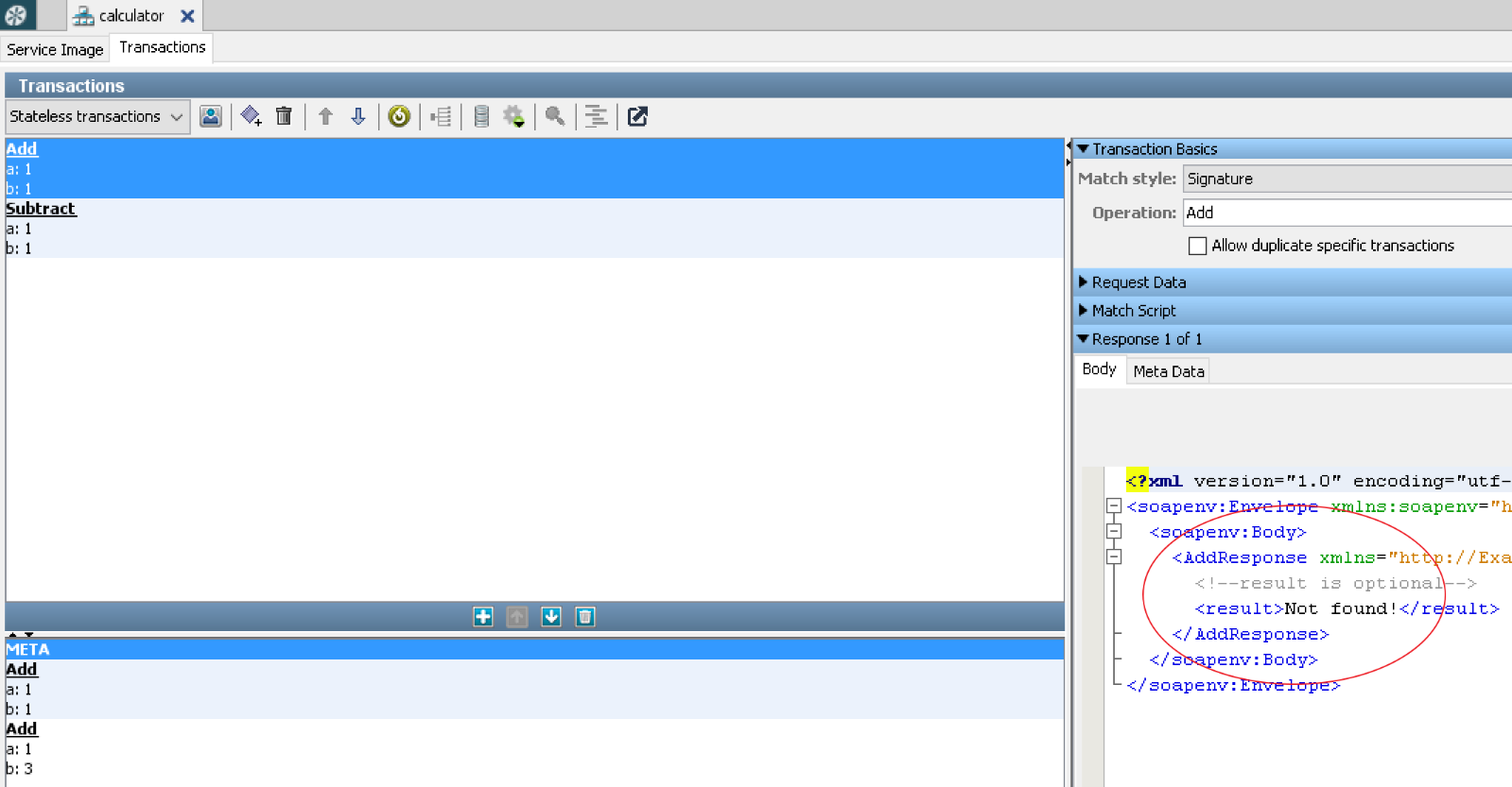

    I think I've found the solution by first selecting the method but no selecting a scenario right away, that will give you access to a "non considered scenario", like this:
    if you select a scenario, like the first one:
    you'll notice it's a different response! and the first one will show every time a scenario is not found.  Like Add operation with 1 and 7 as parameters scenario.  I've tried this using SOAP UI:
