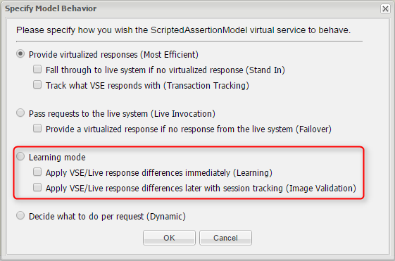

    I think this might be what you're looking for.
    From within the DevTest Console of your VSE, you can set the virtual service model behavior by ::
    - Right-clicking on the deployed virtual service
    - Select "Specify the Model Behavior" option from the contextual menu
    - The "Specify Model Behavior" dialog opens.  It looks like this ::
    You can also create a new recording of the service with the transactions you need and then merge the 2 service images together.

    Some important aspects for the Learning Mode is as follows -
    - This feature was added in 8.0
    - So this option will only show up on VS created and deployed 8.0 onwards
    - If you are using a VS that was created prior to 8.x then the Learning Mode option will not show up
    Let me know if you are outside of those last 2 bullets and yet don't see that option.
