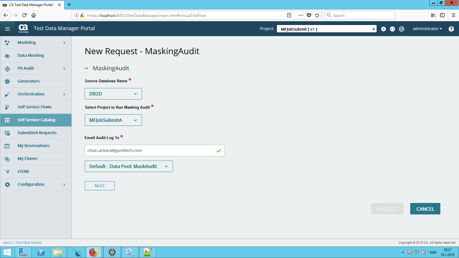

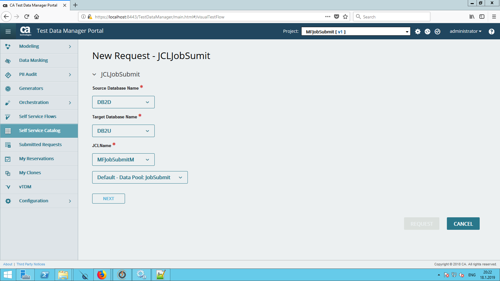

    We developed some custom functionalities which let you use all TDM Mainframe Add-on functionalities through CA Test Data Manager Portal (also through DataMaker).
    Basically, It lets you to submit and run Mainframe jobs to UNLOAD and LOAD masked data from source DB2 system to target DB2 system. You can submit those jobs from CA TDM Portal and get any information (Status, Return Codes, Execution Steps, Audits, Reports etc) about Mainframe jobs submitted in the back round. That means any data requester can run that masking/subsetting jobs without the knowledge of Mainframe. That makes TDM to be used more widely and effectively.

    1. Service Catalog for Mainframe Integration
    2. Submitting UNLOAD(GTXMSKL) and LOAD(GXMSKL2) Jobs to Get Masked Subset
    3. Run Masking Job in Simulation Mode to Get Audit Reports

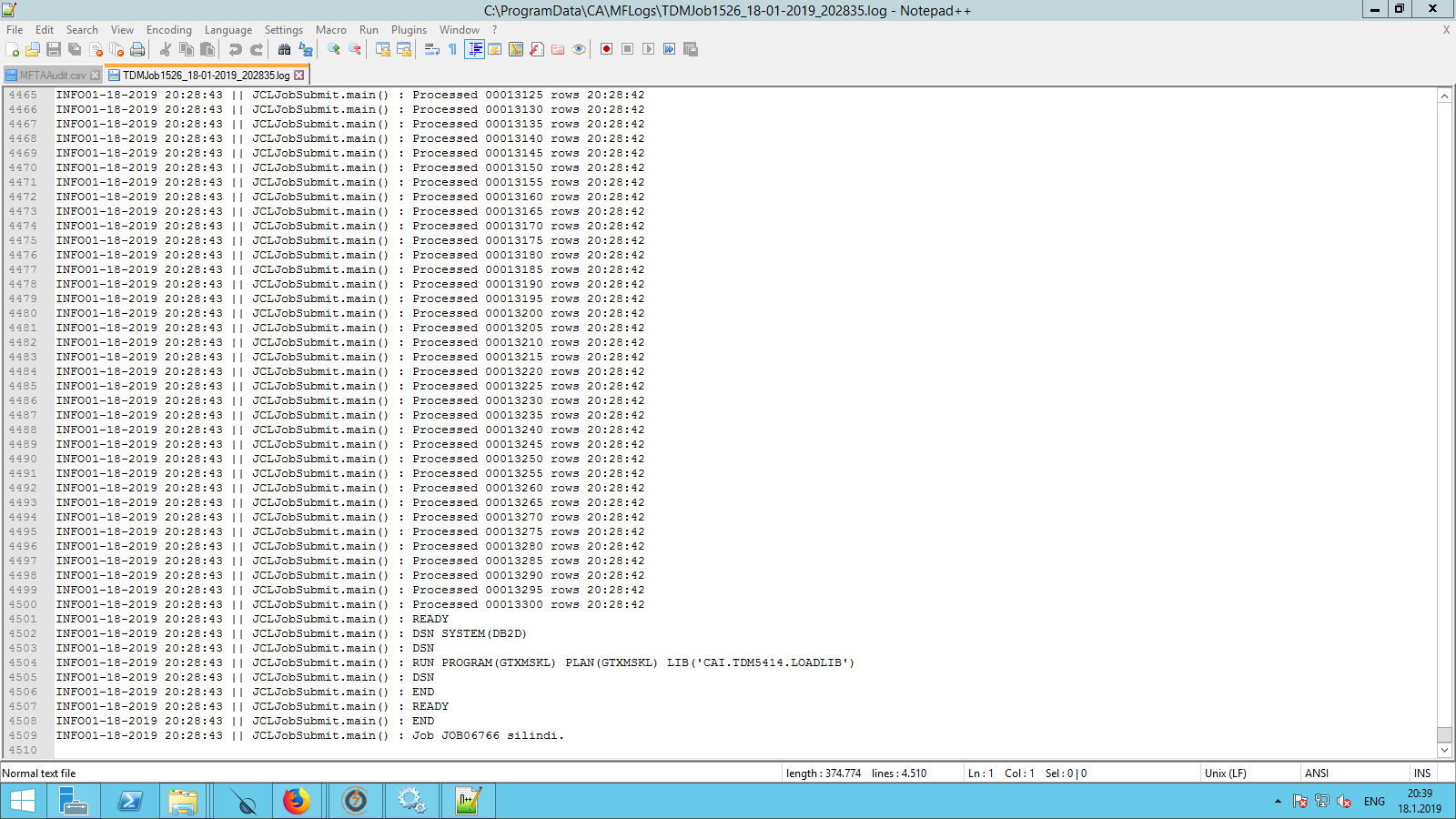

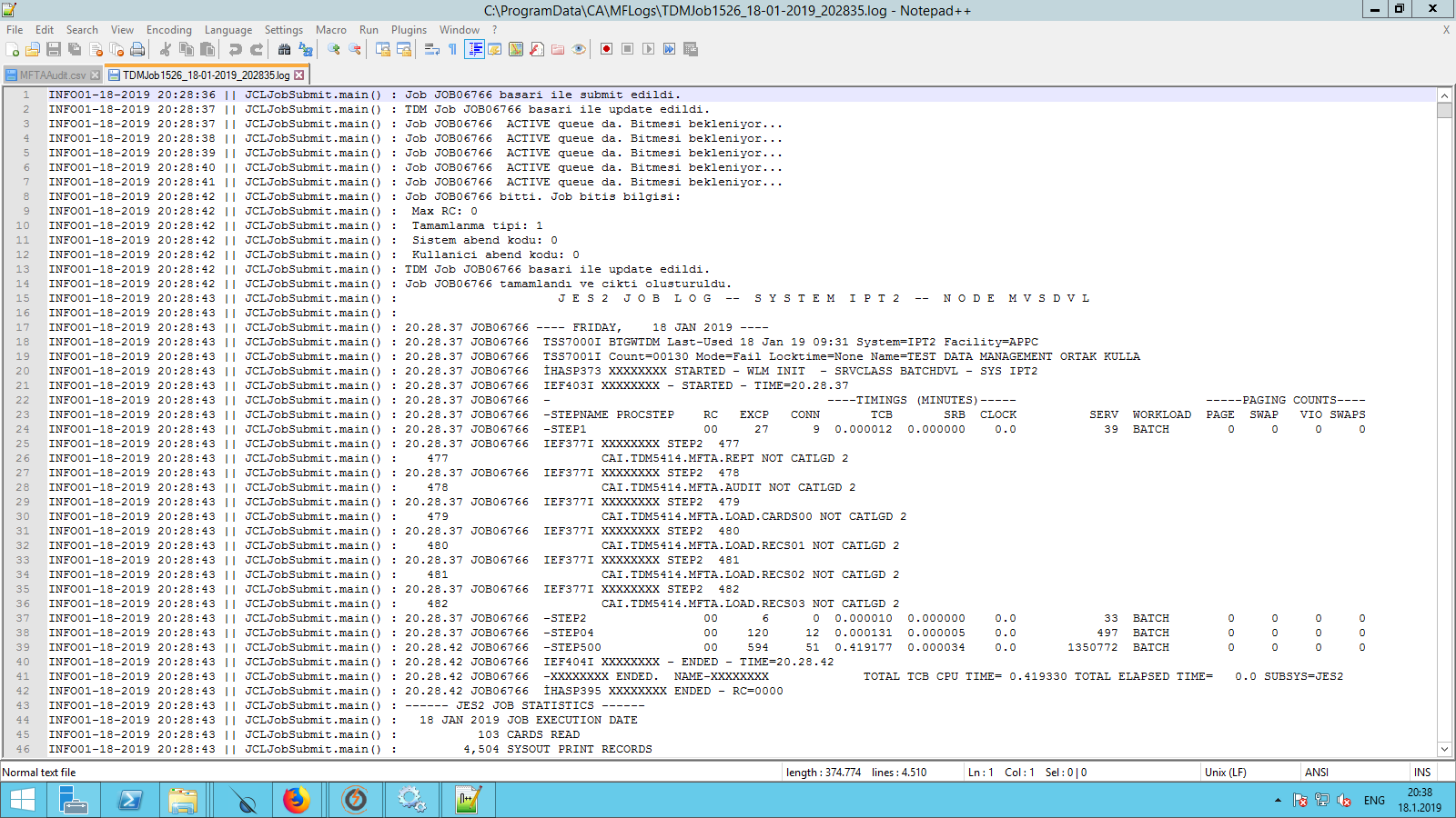

    5. MF Job Logs
    6. Submitted JCL and Outputs of the Job

    This is very interesting. it will be helpful if you tell us how the designed these self service flows. Did you use Javelin to connect to MF?.
  • 3.  Re: Triggering Mainframe Jobs with CA TDM Portal
    Best Answer
    Posted Jan 21, 2019 04:29 AM
    Hi,
    Javelin has the orchestrator role in here. It orchestrates all necessary steps to trigger MF jobs. There is also some custom code development behind it.
