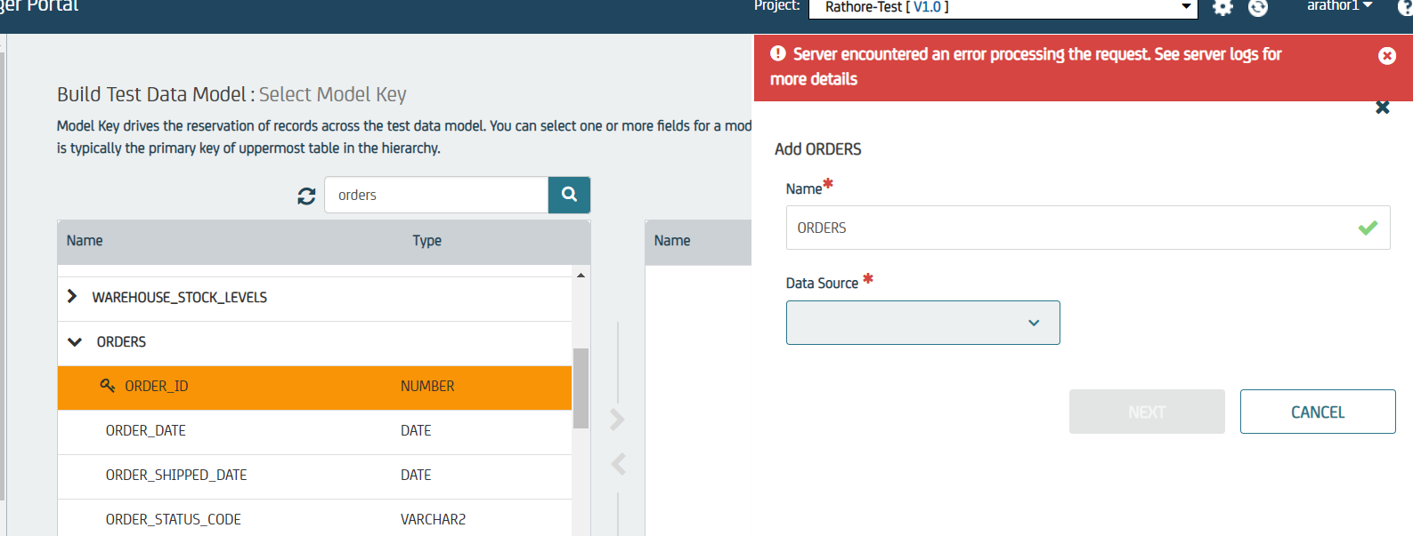

    Hi All,
    i am working on Oracle database and while creating test data model for one of the flow i am getting error i.e. Data Source not found for the selected entity.
    i have already created the environment and under the same i have been creating test data model
    while selecting the model key i am getting error and table is already registered under objects.
    can anyone please suggest/help me with the issues.

    Hi,
       I believe the error you are seeing is because the registered table you are working with is not part of a data source assigned to the environment defined in the model.  Can you add the data source to the environment and retest.
       It looks like you are using the legacy model for find and reserve, if you are using the newer versions of TDM I would recommend using the new Model moving forward.

    Hi Keith,
    Thanks for your reply it helps.
    However now i am facing issue while creating model key PFB error details from the logs.
    2019-03-14 13:38:37.763 UTC [ERROR] [http-nio-8080-exec-3 ] --- [U:arathor1][M:GET][P:/api/ca/v1/environments/404/actions/findDatasources] c.c.t.c.e.h.GlobalExceptionConvertor: HTTP Error - INTERNAL SERVER ERROR: Exception: Invalid column index
    java.sql.SQLException: Invalid column index
    I am doing this exercise on Orders schema and getting the error, can you please suggest something.
  • 6.  Re: Not able to create test data model for Oracle database table
    Posted 03-14-2019 10:18 AM
    Now i am getting Datasource not found in the logs, however i am connected to proper data source and also assign the same connection while new environment creation
    can you please suggest ASAP.
    2019-03-14 14:15:01.145 UTC [INFO ] [http-nio-8080-exec-3 ] --- [U:arathor1][M:GET][P:/api/ca/v1/environments/425/actions/findDatasources] c.c.t.d.s.EnvironmentService: Received connection profile details for the environment 425 in the project 7568 and version 7569
