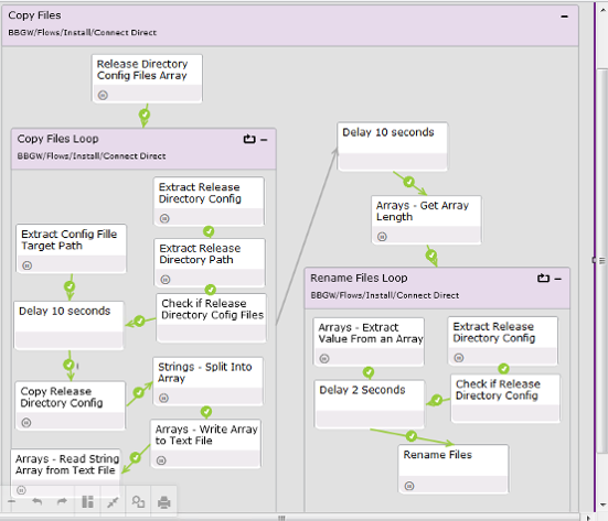

    I need an assistance in a scenario where i want to rename same files after copying in same folder.
    Ex: lmn.cfg_201806, pqr.cfg_201806  (Filenames)
    I copied these files from source path to target path.Now i want to rename these files from lmn.cfg_201806 to lmn.cfg
    Using this flow for above mentioned activities.
    After Copying files Output of ls command is ( where lmn.cfg_180918 and pqr.cfg_180918 are scrap files , we can ignore)
    After Rename :  Output of mv command
    It Renames pqr.cfg_201806  to lmn.cfg (while it should rename mn.cfg_201806 to lmn.cfg ) and for next file it says file does not exist.

    Hi Gregg,
    I am not clear what you are suggesting...
    In loop i am trying to rename the files from lmn.cfg_201806 to lmn.cfg and pqr.cfg_201806 to pqr.cfg..

  • 7.  Re: Loop
    Broadcom Employee
    Posted Sep 20, 2018 10:58 AM
    I don't know if this is what's happening - again, devil is in the details (which in this case is if/where you are using parameters, arrays, etc.. in each of the actions, loops, etc..).
    But, in the example above, please show us what your workflow looked like to produce #2 and #1. And also please show us the properties of the action(s) for that "Check for Sub string in Source" action so that we can be clear.

    Anyway i find out the solution..let me share .(I forgot to add the splitted array loop )
